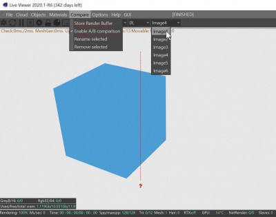

Weirdpictures wrote:bepeg4d wrote:Hi Weirdpictures,
after enabling the AB Comparison, you also need to use the Save Render Buffer command, since it is not stored automatically like before.
Then you will see the AB line, and use the Compare feature as before:
ciao Beppe
Hi Beppe,
thanks for your reply. Yes, we know that we need to save the render buffer, but it wont show up or give us the red line to compare between two images.
Here is a screen recording to show the problem. Again, all works perfect with the R5 release, but R6 and R7 have this problem for us.
Same for me..
C4d R21 / win 10
