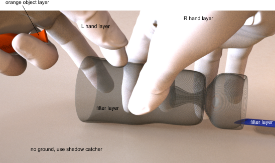

Thank you, Thomas. And, Merry Xmas.
I guess that I have actually done a form of render layering, in that , I have many times rendered with an Alpha layer, so I could produce output independent of a background (added in video editing). I have used the Shadow Catcher for still images. You are right, I should use this for animation.
Effectively, would you say the principal is the same,
- but if I had a sphere on render layer 1 that goes from behind a cube on layer 2 to in front of the cube , the part of the cube behind the sphere is not rendered provided the Materials are opaque?
- Each render layer is its own .png series? Project movies must use a great deal of HD space, or do layers with very little data generate as less file size?
Let me ask you: So aside from more video editing flexibility, would you say that, for example, a 15 second PNG movie done in 4 layers would render faster than the same movie on one layer? Seems like 4 sets of .PNGs to be assembled later would take longer to render??? Or, because of the null - Alpha areas it is faster?
You are absolutely right about the gloves being too bright. And the finger is breaching the table surface. I must fix that. Surprised the client didn't mention it to me. Very late night production on that.
Finally: Layers strategy......would the attached image be a way of approaching Render Layers?
Thanks, Thomas. All elementary to you, and much appreciated.

Hi Rick,
It's hard to give a standard answer to a complex topic. As I said, there are a thousand possibilities to do something. Buying more hardware can be one possibility at a specific problem :)
A problem that will need render layers is this viewtopic.php?f=23&t=58230
Here, I have to use render layers, otherwise you will see the borders :(
Here you have another draft:
https://www.dropbox.com/s/3o2ivnpwpzx4a ... oot-v8.mp4
You will see that the ocean has a strange reflection. It's because lighting for water is - most of the time - a different one. So, I usually use different HDRIs in a scene (for water, foreground, background etc.). The background can be rendered once and then used as a billboard to speed up the whole process.
So, it's a really a big topic and giving tips is really hard :?
I'm also quite sure that you will have to learn After Effects, as Premiere won't give you the possibility to composite layers in an effective way.
For your scene, it's hard to tell how to approach the rendering process. As I mentioned, I usually render the background in another layer. That's what I would try first: seperating foreground from background. But, I guess, you have to first understand the whole process to decide where to use layers and where to avoid them... It's also not easy to say whether layers render faster than a whole composited scene or not... You have to try for yourself, I guess :)
