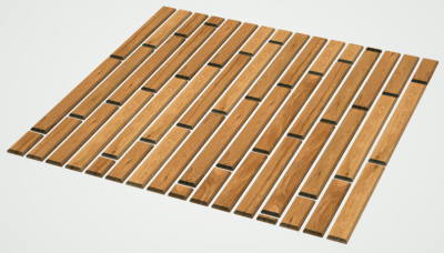

Hi everyone,
This is a script to partition a geometry into isolated elements and tag these elements with an attribute.
This can be used to randomly assign textures to the various disconnected parts of a single mesh.

For this example I will use this floor geometry created in 3DSMax with the FloorGenerator plugin. This is a single OBJ file.

You should get something like the following.
We have assigned colors randomly to the isolated elements of the geometry.
Instead of simple colors, you can use actual textures as the values of the Gradient map's control points, as in the first image.
