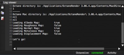

Thank you for upgrade this essential script, but im having problem to load all maps to create each material. My workflow is using Pixplant to export all the maps and then import to octane (if you guys have another suggestion to create in a quick and easy method, please advise me : )).
But when i load the first map, right after "ok" i receiving a messsage that the "_roughness" cannot me loaded. I´ve attached the print for the error and created the same material in different ways to see if the map is generated with any problem, but after change some configs in map doesn´t work at all.
Sorry for asking more help but i really need to understand what is happening.
PS. Added the maps generated in Pixplant with addition of the same roughness converted in .jpg file
Re: MBB QUIXEL PBR material with Lua
Posted: Mon Jun 26, 2017 3:59 pm
by bepeg4d
Hi anereton,
the script assumes that all the maps shares the same file format of the albedo map.
If you create the Log window from the Windows menu, you can see that also the Displacement map is not loaded before creating the material:
I can add a more evident error message, or think at a way to skip the file format :roll:
ciao beppe

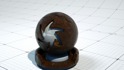

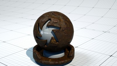

So I tried to compare:
Albedo mapped to the PBR script, and I plugged in all the pieces (Albedo, Roughness, Metalness, Normal, Displacement)
VS
Albedo and all the pieces mapped to a Glossy shader
The PBR material, at default, seemed to render very fast, and I wasn't sure if I am seeing this correctly.
I ran at 1920 x 1080 res, to a sample limit of 50, because it will render to whatever you set it at...
But it seemed to be earliest done at 50...Fifty, not a mistype....Fifty. (It took 1 second w/4 Titan X.)
And, here is my best approximation on the Glossy of the look the PBR one it gave, I can't match it exactly, they work different somehow. Look how the lighting hits it, it's almost like a different angle or something.
But here is the big thing, at 50 s/px, the PBR render looked good. At 50 s/px, the Glossy render showed hot pixels and was grainy (unfinished), so I included a pic of the HP removal on as well...
But, Look! Is this the future we are seeing?
Octane + PBR = a good looking result @ mega speed? :P
Albedo PBR
Albedo PBR
Albedo Glossy
Albedo Glossy
Albedo Glossy Hot Pixel Removed

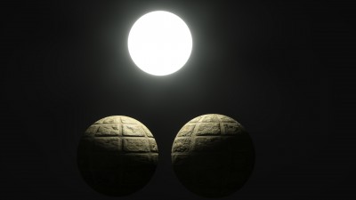

Here is a head 2 head battle with a texture emission diffuse, stopped render at 50 (fifty) s/px, @res of 3840 x 2160:
PBR to left of me, Glossy to my right
Here I am, stuck in the middle with you..
