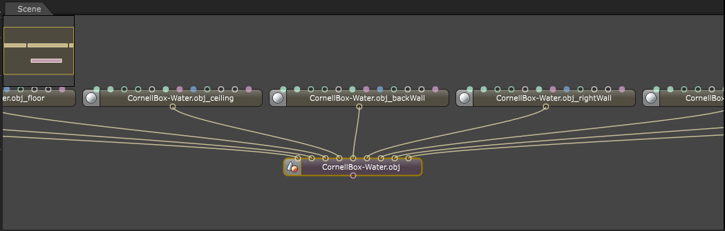

Here's the before and after:
before running the script
after running the script
cheers,
Thomas
