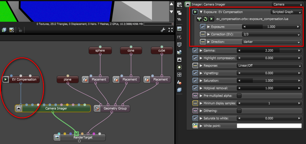

Hi all,
Beppe asked yesterday how to calculate the exposure using some EV compensation like in a real camera. So I wrote a small Lua script graph. In case somebody finds it useful, you can get it here:
ev_compensation.orbx
(3.69 KiB) Downloaded 1062 times
Again, just import the package and connect it with the exposure pin of the camera imager node:
Happy rendering,
Marcus

Posted: Tue Dec 16, 2014 9:50 am
by bepeg4d
big thanks Marcus, you are a genius :)
it works very well :)
the ability to save the scripted graph nodes in the LocalDB is fantastic, drag and drop and go, simply great ;)

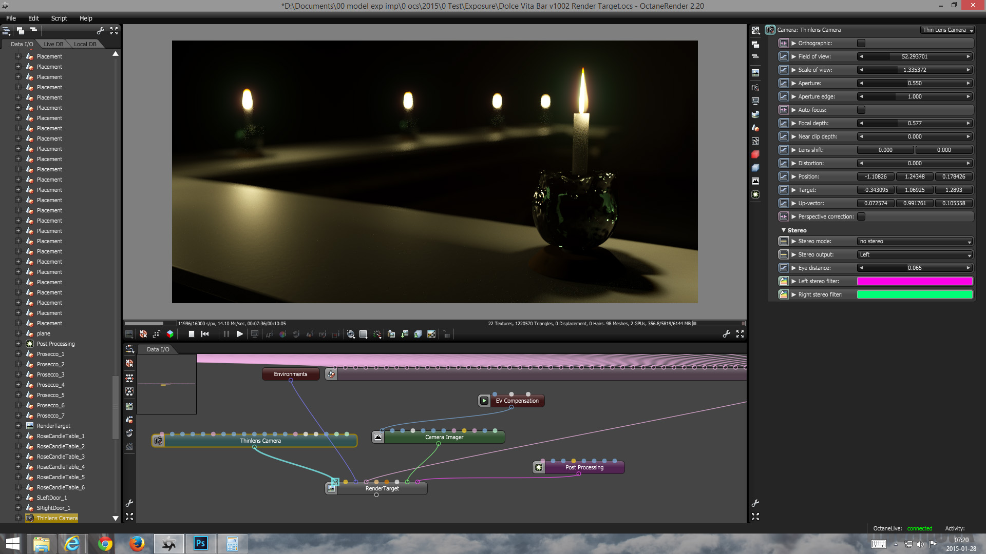

abstrax wrote:Hi all,
Happy rendering,
Marcus
Very useful indeed. Thank you a lot for providing this option! :D
Since I am used to EV steps from photography fine tuning the exposure that way is very conveniant.
