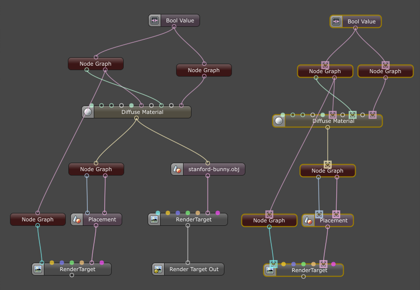

Hi Everybody,
Here's a little script to copy and paste a full node tree. The root of the tree is the selected node. To use it, just select a node and run the script. The script is mapped to
This only works with release 1.34 and higher.
Here's a visually what the script does:
cheers,
Thomas
alt + c
but you can change this of course. Might be useless 99.99% of the time but I think it's nifty This only works with release 1.34 and higher.
