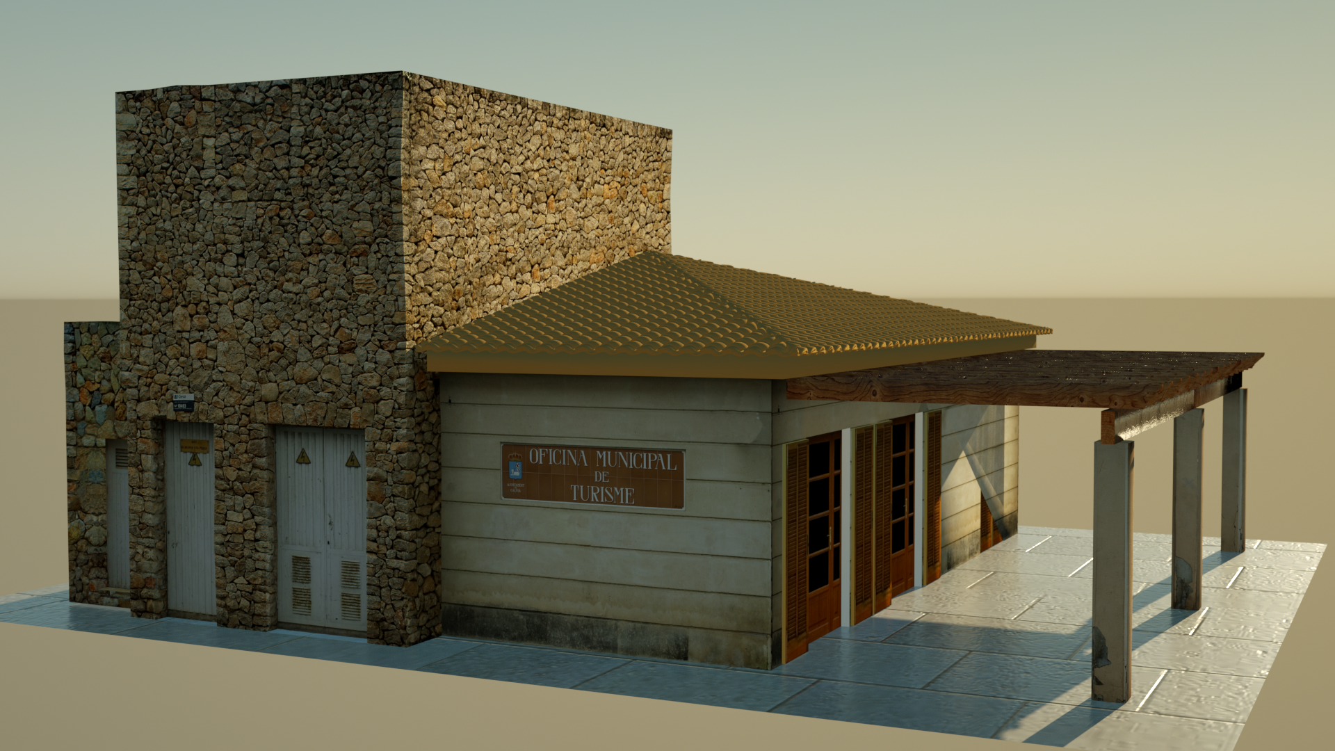

gordonrobb wrote:Took the plunge and bought the bundle. So far it's great.
The attached is an object I had set up in LW with image maps etc. When I export it as an OBJ, and load it in the standalone app, after a bit of jiggery pokery, this is the result. The images map to the UVs just fine. However, when I try to set it up in LW, I can't find anyway to assign an image where the image uses the right UV. Any ideas about what I could be doing wrong?

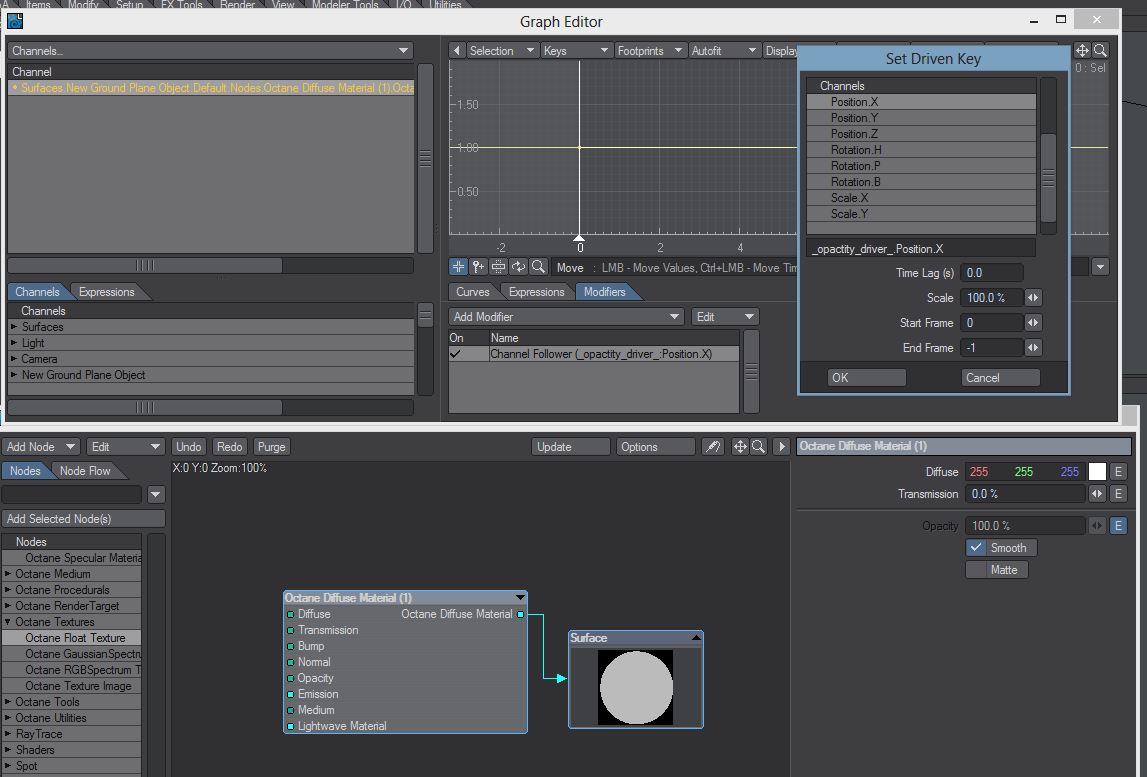

gristle wrote:Is there any way to get Octane to use object dissolve settings? Even an on/off option would be good, rather than having to set opacity in the material.
gristle wrote:You cannot keyframe disable though?
juanjgon wrote:Do you have more the one UV maps in the object?, octane doesn't support more than one UV map and i a vertex has more than one, plugin select the first one ... if you want to send to me the scene I can test it and tell you what may be the problem.
-Juanjo
