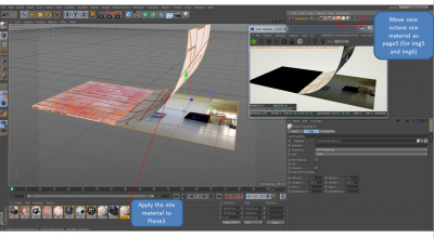

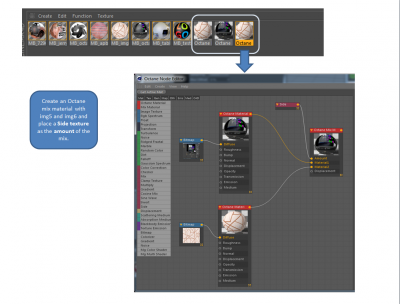

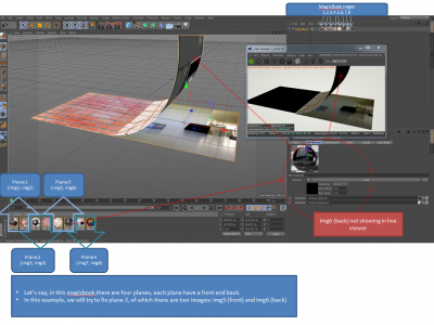

(1) setup the magicbook: (2) recreate the pages as octane mix materials, eg for images on page 5 and 6: (3) apply the mix materials, eg: At this point, you'll notice that the back page of the leaf (plane) needs to be flipped horizontally...

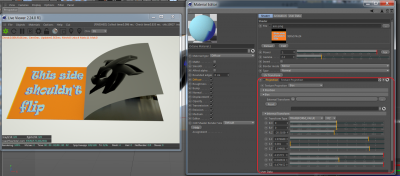

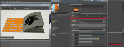

(1) On the shader attributes of the image that would be placed at the back of a plane, switch the border mode to "mirror": (2) Have a play at the internal transforms of the box projection: and that's it, have fun. cheers...
