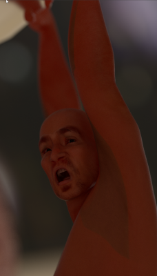

Any way to avoid this other than scaling up?
I tweaked ray epsilon, but at some point those strange self-shadows appear. can I tweak something within octane/materials to treat scaled-down/scaled up figures as if they were normally-sized?

I think Poser figures should not be scaled down, otherwise the vertex density will be too high. Instead, scale everything else up. You can do this in the Settings with the Poser to Octane Scale Factor.
Paul

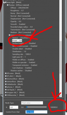

Of course. here it is...
what i meant was: can I change the max cap value of an emmiter's power to be more than the 100000.0 max that is at the default? (for the sake of allowing me to scale up my scenes...I must scale the lightning power, and it grows exponential: if I scale up a scene *10, I need to scale up the light's power *100! and so on...)

100000 is the maximum emitter power that Octane will allow.
Paul

face_off wrote:100000 is the maximum emitter power that Octane will allow.
Paul
I see...so I guess HDRI is my answer for extreme situations (those won't lose power regardless of scaling).

You can also scale your emitter geometry.
Paul
