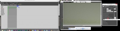

When I tick camera motion blur, Poser always starts scrolling down the animation from beginning to end in the animations palette windowl.
I'm starting to create beginner and long scene, so this is starting to annoy me. Especially if I tick it by mistake.

face_off wrote:I'm sorry - I don't understand your issue. Can you provide more details and a screenshot showing the issue pls?
Paul
Okay, as shown in the screenshot, when I tick the motion blur setting (the red circle) the animation slider (the blue arrow) in the animation palette window starts scrolling down the timeline. Starting from frame 1 to whatever the ending frame is set to in the scene. And it's slow too. The animation slider stays on each frame for 2 seconds or more depending on how complex the scene is.
Paul
Okay, just ran some test and discovered it only happens when the animation palette window is open. When it's closed it doesn't do what I posted earlier.
But can you make sure this is the case? And if possible, fix it. I spend a lot of time in the animation palette window.
Hi - when you tick Camera Motion Blur, the plugin need to scroll through the entire animation to capture the camera track - so what you are seeing is the correct behavior.
