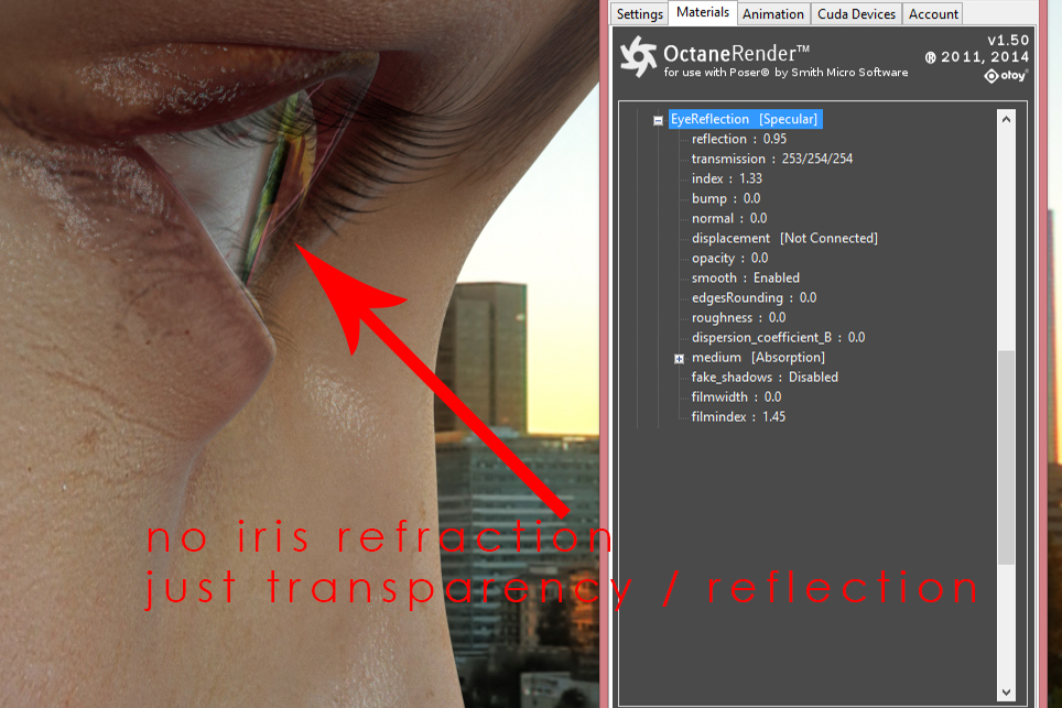

The result of a Genesis 2 character pictured in the attached image, with proper light placement and the material settings as shown in OctaneRender, obviously do not deliver a realistic result.

Since OctaneRender is using the physically correct IOR (or just "index") value for determining the refraction of an object, this is out of the question since index values between 1.0 and 8.0 didn't get the desired effect (again: no volume)
I tried to manually place a sphere between the eye reflection material and the cornea/iris and set that to the IOR of water - no effect so far.
