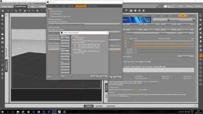

Libraries are assigned in the Content Directory Manager of DAZ Studio.

-> after each new installation of any DAZ Studio version check the Content Directory Manager if libraries are set up properly

- If the user does not manually add the libraries locations in the Content Directory Manager DAZ Studio will not know where to look for product files
