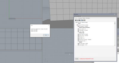

This one resulted after I moved the test scene from my desktop to my archive. After opening the scene again after the relocation, I started octane to see what happened.
first I got this error message:
unfortunately unlike the normal octane material without graph editor, I do not get prompted with the possibility to search for the missing maps.

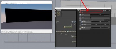

then I opened the graph editor:
As you can see the place where the image file path is supposed to be is completely empty.
All in all this means that the use of my new beloved NodeGraph is very dangerous, since every broken link results in the inability to repair it due to the lack of any usable information.
This is a real showstopper for professional use IMHO.
Yes, this is a problem. When the .3dm file is loaded by Rhino, the nodegraph materials are simply XML text - not Octane Image nodes (where the existence of the file is checked). There is a hook in the Octane API to capture the event of missing assets, however it is not working, and I have reported the issue to OTOY. If this is fixed, it might be possible to come up with a solution (however it may not be simple - as the Octane "missing asset" event hits the interface layer between RhinoCommon and the Octane API, so it may not be possible to pop the standard "search for missing texturemap" dialog. I would need to investigate more once the Octane API end is working correctly.
The other solution could be that the plugin parses the XML strings that contain the filenames and check for their existence.
In the meantime, yes, it's an issue that you need to carefully manage.
Paul
