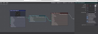

But here comes the question, How do I use the baked textures in Octane? Just throwing the textures on the selected (Glossy) surfaces doesn't do the job, since the scene still needs lights to be visible. I tried eleminate the lights and make the surfaces bright to show up the baked textures (with blackbody emission), but this obviousely doesn't work...
Finally I used the Lightwave native render to do the job, and this works fine, I can just set the luminosity to 100, put on the baked texture and this way I can turn off all the lights and the scene shows exactly like in Octane. But it misses some of the reflections Octane does so well...
So, does anyone has an idea on how to pull this off in Octane?
