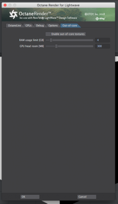

Hi Everyone,

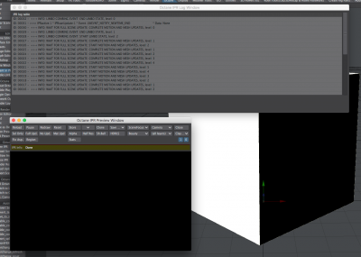

I just installed my upgrade to Octane 2018+LW2018-plugin, and am having a very unusual difficulty with the IPR functionality.

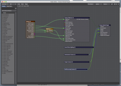

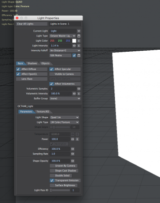

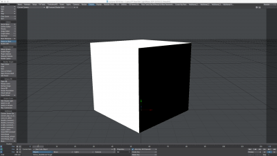

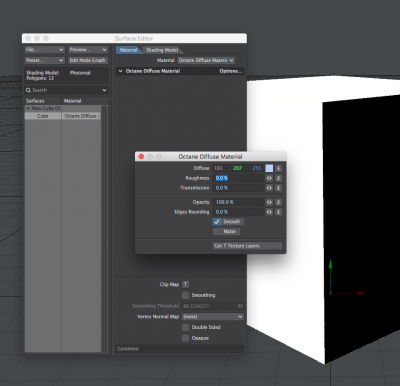

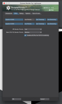

I set up a simple scene: one cube with Octane Diffuse Material applied, one Octane Area Light, a basic Octane Render Target (see the included screen shots for details) When I select Open IPR
1) IPR opens
2) starts the log
3) immediately becomes unresponsive
4) locks up the LightWave interface
5) making me force quit Lightwave 2019
This worked flawlessly with Octane 3.0.8+LW3.08.2.0-plugin.
When I attempt to do an F9 frame render, Octane crashes and refers me to the octane.log file where I found this:
00:00:00 (0000.69) | ... Init rendering ...
00:00:00 (0000.86) * OCTANE API MSG: CUDA error 715 on device 1: an illegal instruction was encountered
00:00:00 (0000.86) * OCTANE API MSG: -> kernel execution failed(kernel0)
00:00:00 (0000.86) * OCTANE API MSG: -> failed to deallocate device memory
00:00:00 (0000.86) * OCTANE API MSG: -> could not get memory info
00:00:00 (0000.87) * OCTANE API MSG: CUDA error 715 on device 0: an illegal instruction was encountered
00:00:00 (0000.87) * OCTANE API MSG: -> failed to load module
00:00:00 (0000.87) * OCTANE API MSG: device 0: failed to load compiled OSL code:
00:00:00 (0000.87) * OCTANE API MSG: device 0: failed to compile module 0
00:00:00 (0000.87) |
00:00:00 (0000.87) | ++++++++++++++++++++++
00:00:00 (0000.87) | +++ RENDER FAILURE +++ processing the failure callback

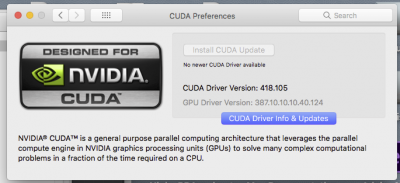

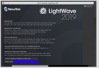

I have the latest CUDA drivers on my system (see attached screen capture)
So what's happening here?
I'm attaching several screen shots so you can see what I am trying to do, as well as the entire octane.log file
Please help! I need to get this working as soon as possible?
Many thanks for any help with this!
Reid Perkins-Buzo
