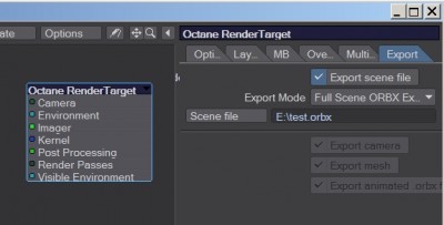

The ORC is a bit experimental in the LW plugin yet. How are you uploading the scene? From the IPR window you are going to upload only the current frame. To upload the full animation you should export an .orbx file using the render target root node options, and upload this file to the cloud.

Tried to run the render on the cloud again today. Whatever I try to do - I can not get more than 2 frames of animation in my file. Could you explain this procedure in more detail - step by step?

The export scene works rendering the scene with F10. Enable the export .orbx option in the render target and press F10, like to render the sequence on your local machine. Exporting an animated scene as an .orbx file has nothing to do with the IPR. From the IPR you only can export the current frame.

But if I press f10, then begins the render of the scene.

With this option enabled? ... F10 should export the scene without rendering it. Be aware that the export feature only works in "update scene" rendering mode.

Thank's, it's working.
