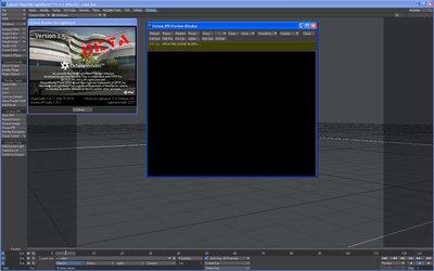

Postby gigi » Tue Feb 25, 2014 8:30 am
gigi Tue Feb 25, 2014 8:30 am
I have a similar problem, but my scene is simple. is a plane with a cube!

Re: OctaneRender™ for LightWave™ 1.5 beta - build 1.31.2
Postby gigi » Tue Feb 25, 2014 9:11 am
gigi Tue Feb 25, 2014 9:11 am
juanjgon wrote:
gigi wrote:I have a similar problem, but my scene is simple. is a plane with a cube!
Can you test the plugin with Layout x64?
-Juanjo
Sorry, but only x32!
