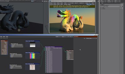

UnCommonGrafx wrote:This should be easily possible. Best place to start is the camera tip which tied dof of Octane to the native LW camera. That's a great example of using the native maths with Octane.
From there, remember to look at all the suggestions in the other thread, two info nodes subtracted ought to get you what you want. Variants could be extracted from the thread.
Yes, you can use the item info node to drive the gradient's input texture parameters, for example it's position. In this example you can see how to build a gradient parented to a Null object to mix two textures using the gradient node. You can animate the Null in a sequence without problem. The only issue is that you don't have a real time update in the IPR, but if you enable the "Mat.Upd" button, every time you click on "Redraw" the material is going to be updated without reload scene.
