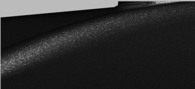

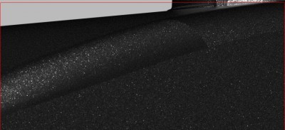

Hey there,
i have a lot of shading errors with my current cad project. I tried to edit the normals, but it always looked the same in Octane. I tried to use the Modo Rendercache and Voila: Errors resolved. Genereally i don't like to use the rendercache since it's not reliable. Is there a way to fix this?
I'm using the current Modo (12.0 and 12.1) and Octane Verisons (3.08.2.133)
edit: This Trick only works with 12.0. In 12.1 the error stays
Rendering with Rendercache ON
Rendering with Rendercache OFF
Thanks in advance

sorry for the delay. Here is a scene for you and also a few renders. You can see that the normals are different. Something is going wrong with the smoothing, i think.
This works only in 12.0 and it doesn't matter which version of Octane is used (as far as i know). Render Cache off produces errors, render cache on does not.
Thank you for looking into this!

I think the problem is the UV's on the mesh. If you view the UV render pass you can see the problem.
Paul
Re: CAD Data Normal Problem
Posted: Wed Oct 31, 2018 2:33 pm
by Hesekiel2517
Hey Paul,
thanks for looking into this. This solved the problem (both making new UVs and simply deleting them). Are the UVs effecting the normals? Since it's CAD Data the UVs are totally unusable. So Material uses only Linear Projection. Furthermore this Problem also shows up with no textures at all. Also why does it work if the rendercache is used? I'm glad that this helped, but i really don't understand why :)
