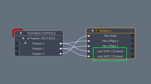

Hi Paul I'm having some trouble again with the Octane IPR updating/refreshing. I've setup a null to control the cameras Film Back settings via a simple node setup: the Film Width, and Film Offsets being driven by moving a null (great way to interactively pan/zoom to areas of interest). Problem is the Octane IPR does not update until after a frame shift.
If I select the Film back channels and hit "C" (modo channel haul tool) this updates fine in Octane IPR. But for some reason when using nodes to drive these values Octane doesn't see the change.
Or if anyone else knows a better way to do this so it will work with Octane that would be awesome.
Please see my scene attached. Select the item "FILM BACK CONTROLS" and move it around in the TOP and FRONT viewports.
