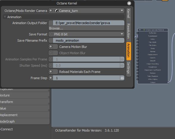

hello guys, I'm using this post for the opposite problem.
I have a scene where is only the camera to moving, MODO should refresh only the camera movement, but every frame it reload all the geometry and spend a lot of time!
All the meshes have the option "live geometry update" disable.
Another strange point is that in my kernel option there isn't the option to load all the animation in octane, to avoid this timing lost (see attached).
Thank you for your explanation.
Can you pls update to the latest version of the plugin, and if the problem persists, let me know.

Hello Paul,
as you can see from the screen that one is the last version of the plugin. I updated it just yesterday before to write here.

Postby face_off » Sun Jul 02, 2017 11:14 am
face_off Sun Jul 02, 2017 11:14 am
My apologies, I see now you are on the latest version.
Ticking Camera Motion Blur should resolve your issue.
"Load All Frames Into Octane" has been renamed to "Object Motion Blur" (this is in the release notes, but I need to update the manual).

Postby balaccog » Sun Jul 02, 2017 4:39 pm
balaccog Sun Jul 02, 2017 4:39 pm
Hallo Paul thank you for you answer.
Unfortunately it looks as it isn't work.
First I try to render with Camera Motion Blur enabled, then with Object motion blur and at least with only Object Motion Blur but still every frame it "Refreshing Octane Geometry".
I repeat, no one geometry is moving, is only the camera moving and in this way I'm wasting a lot of time.
Thank you so much!

Postby face_off » Tue Jul 04, 2017 3:00 am
face_off Tue Jul 04, 2017 3:00 am
Hi, if you have ticked Camera Motion Blur, and all Mesh items have Live Geometry Update UNTICKED, and Reload Mesh Each Frame When Animating is UNTICKED, then the geometry should not reload between frames. If these settings are not working for you, could you pls send me your scene, and I will investigate further.
