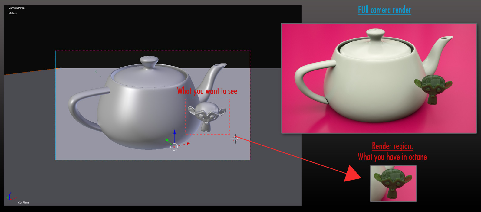

What do you mean? A way to exclude from exporting all the objects that are not present in the "render region" viewing box? Possibly it could be done, but you cant exclude "off-screen" objects and then stitch parts of the whole image together, cause the lighting & reflections will be all different.
The only way to do proper region rendering is in Octane.
EDIT: Unless if you mean exporting the scene with a camera and resolution adjusted to match the render region defined in Blender?

My vision is more simple, a "standard" render region, you select a region with alt+b and this region is exported to octane.
i think it need a fov and camera shift conversion to keep the same lens distortion with the render region height/width a kind of wysiwyg without any display object modification.
edit: that's i already do manualy in octane, to render each individual part of a scene and keep the same lens distortion of the overall view.
edit2: and obviously it need to automaticaly disable vignetting.
i7 8700k / 16Gib / GTX980Ti 6GiB / win10x64 1803 / Blender 2.78a / drivers 416.34 + Octane 4.0 Standalone / OctaneBlender

Back in the days when I kept up an exporter for Indigo I remember you could find the camera and render region info in the python api. I suspect that same stuff is still there with 2.6x so it would be possible to do as you ask. You want the camera to just view/render that area in Octane, right?
