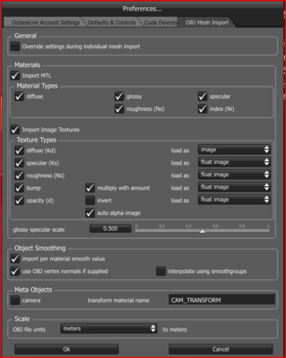

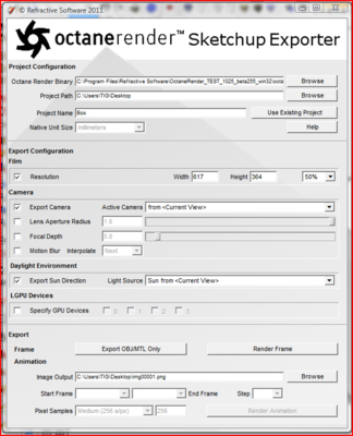

Your OCS Preferences should look something like this [always meters!?]
The exporter always uses 'meters' even if you are using some other units in the SKP. Meters is always the units exported into the OBJ.
If you make an OBJ file by some other means, then you must ensure its settings are to use meters and triangulate faces etc too...

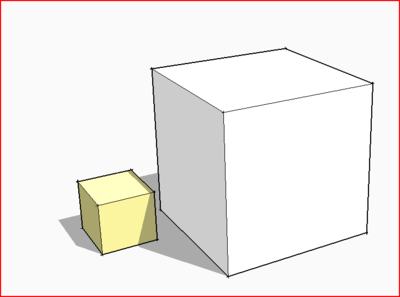

My test SKP looks like this.
My Exporter dialog settings look like this
[the fact it automatically shows unchangeable 'mm' as the native-units is academic - that IS the units I an working in BUT the OBJ is always made in 'm' irrespective of the units - showing 'native-units' is simply a requirement of RSL's exporter dialog standardization - some applications would need you to set this - SKP does not]. Your OCS preference's units should always be set to 'meters'.
My test OCS looks like this.

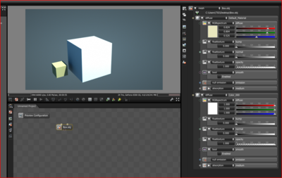

The reason there is always a 'Default_Material' [even if it doesn't appear to be used] is that every exported face needs a material - even if it doesn't have a material in the SKP. That material lists first as it's always the first material defined in the MTL. If you haven't given a face a material the 'default' is used in the SKP - as set in your SKP's current Style. Here I've made the default-front-face-material 'creamy'. The smaller cube has no material applied in the SKP and so in the OBJ and thence in the OCS it takes that creamy 'Default_Material'. The larger cube has the white 'color_000' material. If a material wasn't specified for a face I suspect that the OCS would render it in a 'black' material [0,0,0]. At least with this approach the OCS rendering looks like the SKP - e.g. if you have missed a material off a particular face, rather than a 'black-hole'...

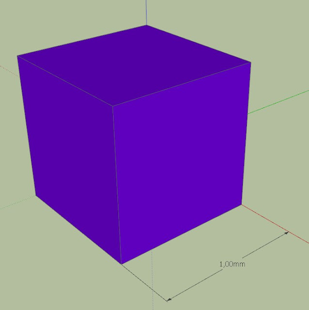

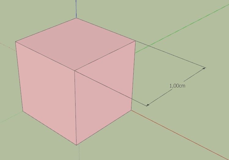

Postby smicha » Sun Nov 06, 2011 5:48 pm
smicha Sun Nov 06, 2011 5:48 pm
TIG,
Thank you for your reply. Please forgive me being to precise and posting many screen shots. I still don't get some aspects of importing mesh from sketchup.
I set units sketchup to centimiters
but as you said this doesn't matter.
My purpose is to create a cube 1x1x1m. So I created a cube 1x1x1 cm - not meter. As Refracty had said I have to /scale divide my model by 100 and I just did it.
My settings are as yours
I also read my mesh preview resolution from octane
and set it into Sketchup Exporter

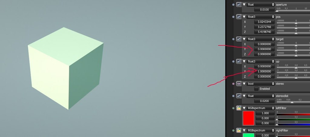

After exporting I got well placed cube but "target" and "up" are strange (why?)
As I tried to rotate or move my object it just gone outside the preview area
So I reset camera view to default and manually corrected target and up as follows
Now I applied "brick material" form LiveDB
and my cube looks good (I repeat that this is 1x1x1 cm cube - not 1x1x1 m).
So if textures form Live DB look good on scaled 100 times mesh and Sketchup Exporter "knows" what units are predefined in Sketchup, why do we have to scale our mesh manualy? It is just a matter of scaling by 100, even if I choose millimeters (Am I wrong?). Now I understand what Refracty was talking about (or I don't :) )
Please take a look what happens if I create 1x1x1m and 1x1x1 mm cubes:
Object gone after moving it
And after resetting view I can easily control its location
But materials from Live DB need to be corrected (or my mesh scaled by a 100 down)
Same for 1x1x1mm cube
and for such scales I am loosing DOF (depth of field) although I set aperture to minimum - again scaling is required
and Live DB texture are also too big
Summarizing my questions:
1. Do I have to manually scale my meshes by 100? If I build a cube 1x1x1 m it must be resized to 1x1x1 cm?
2. What am I doing wrong that "target" and "up" I have to set manually to 0 0 0 and 0 1 0 respectively.
Again please forgive describing it in explicit detail and thank you so much for your time and help.
Sebastian
PS. Forgive me also my English.

The camera values are coming from the exporter. The up vector seems to be chosen to be perpendicular to the viewing direction. The camera navigation in Octane interprets the up vector as the vertical up direction in the scene (usually [0 1 0]).
The camera rotates around the point given in "target". You can pick a target point on the cube with the zoom picker tool.
The brick texture is an image texture, so its scaling doesn't depend on the size of the cube, but on the UV mapping. The scaling of volumetric textures on the other hand depends on the size. The size of the cube seems to be correct.
And in the black render halfway your post the camera position somehow ended up inside the cube.
