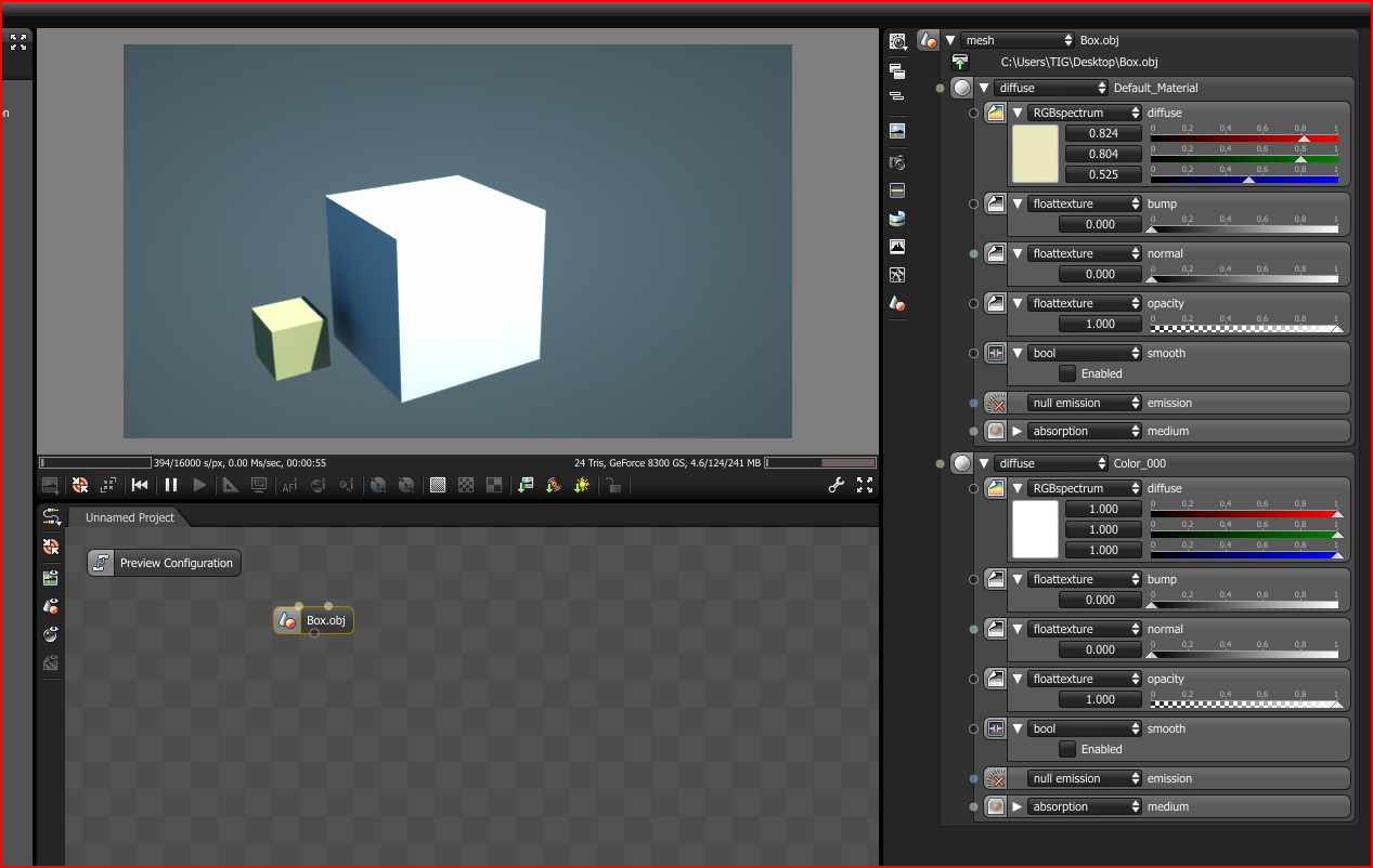

by TIG
Your OCS Preferences should look something like this [always meters!?]
The exporter always uses 'meters' even if you are using some other units in the SKP. Meters is always the units exported into the OBJ.
If you make an OBJ file by some other means, then you must ensure its settings are to use meters and triangulate faces etc too...
My test SKP looks like this.
My Exporter dialog settings look like this
[the fact it automatically shows unchangeable 'mm' as the native-units is academic - that IS the units I an working in BUT the OBJ is always made in 'm' irrespective of the units - showing 'native-units' is simply a requirement of RSL's exporter dialog standardization - some applications would need you to set this - SKP does not]. Your OCS preference's units should always be set to 'meters'.
My test OCS looks like this.
The reason there is always a 'Default_Material' [even if it doesn't appear to be used] is that every exported face needs a material - even if it doesn't have a material in the SKP. That material lists first as it's always the first material defined in the MTL. If you haven't given a face a material the 'default' is used in the SKP - as set in your SKP's current Style. Here I've made the default-front-face-material 'creamy'. The smaller cube has no material applied in the SKP and so in the OBJ and thence in the OCS it takes that creamy 'Default_Material'. The larger cube has the white 'color_000' material. If a material wasn't specified for a face I suspect that the OCS would render it in a 'black' material [0,0,0]. At least with this approach the OCS rendering looks like the SKP - e.g. if you have missed a material off a particular face, rather than a 'black-hole'...
