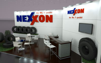

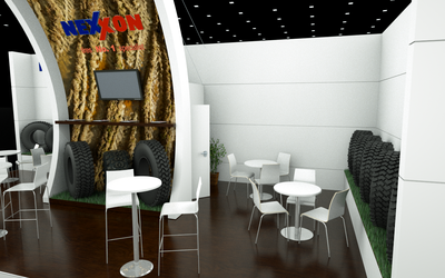

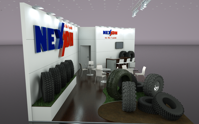

Thanks TIG for the answer.
I'm not having a scene with shots from a big distance ... so i'm not able to use less geometry in the background as you suggested.
one of my projects was the one attached. and i have tried with a lot of grass but i did not let it until the end of export.
then i reduced the number of the grass, but as you can see it is a little bald :lol:
i'm trying now to populate the surface with some triangles (one simple color) and to see what is happening ...
sample grass rendering

Perhaps a slightly modulated mesh with a 'grass texture' and use some bump-mapping etc ?

the file without grass was exported in 7 min. and had~ 820.000 triangles in octane
then i have made 3 comps for the grass straws - used the crowd function => ~12000 grass straws. generated.
The export time in this case is 24min and the file in octane is having 1.300.000 triangles.
And now the patch of grass is not bald any more ... :D
