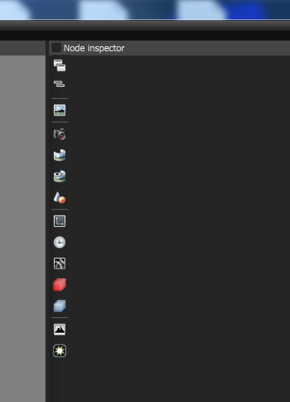

Now can we have in the next update the icons on the right panel for camera, environment.....?
...and SubD options for geometry nodes?

smicha wrote:Now can we have in the next update the icons on the right panel for camera, environment.....?
I've been talking to the Octane SDK team about this. The icons are missing because differences in the underlying architecture make it difficult to add them. (Although they look very similar, the user interfaces of standalone Octane and the SDK used by plugins have many differences under the hood.) Adding the icons back in is on their to-do list, but I'm afraid we don't have any ETA for that yet.

Just to be clear - I mean the icons in the node inspector window. These are present in the Standalone. If we are talking about the same thing any ETA is fine, just don't forget about it. It would ease searching for the most important parameters.
