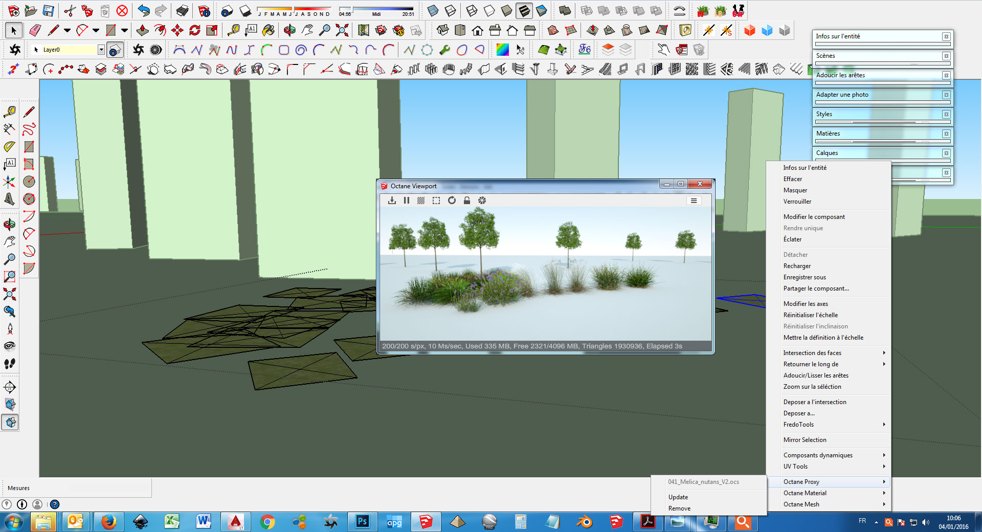

Postby Interfaces » Mon Jan 04, 2016 9:24 am
Interfaces Mon Jan 04, 2016 9:24 am
max files are too large to be used in Sketchup, uses proxy, it works well

Postby Jorgensen » Mon Jan 04, 2016 9:37 am
Jorgensen Mon Jan 04, 2016 9:37 am
but the problem is that i can't use proxies created in the standalone version. they don't show up.
but it works fine if i export an object as .ocs from sketchup.

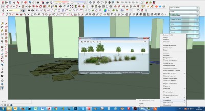

Postby Interfaces » Mon Jan 04, 2016 10:35 am
Interfaces Mon Jan 04, 2016 10:35 am

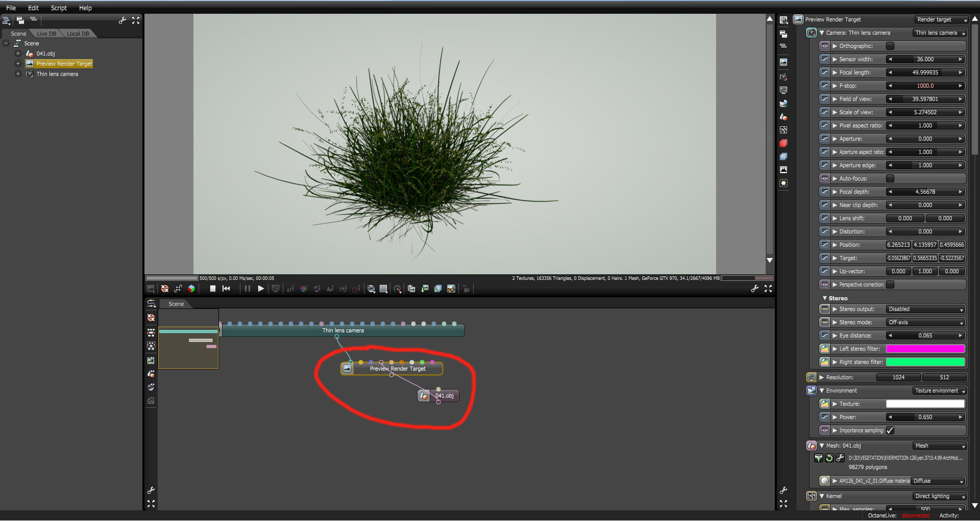

it works very well if the stand-alone
remarks:
- In the standalone connect obj to preview render target
- for the render in Sketchup requires only one open file

Postby Jorgensen » Mon Jan 04, 2016 12:56 pm
Jorgensen Mon Jan 04, 2016 12:56 pm
yes yes yes - it was the render target that was missing - now it works :-)
