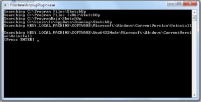

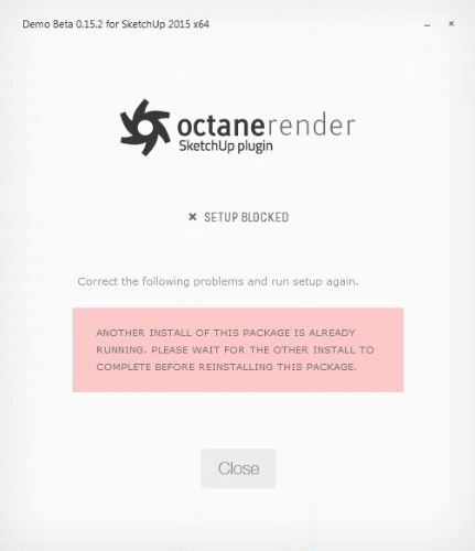

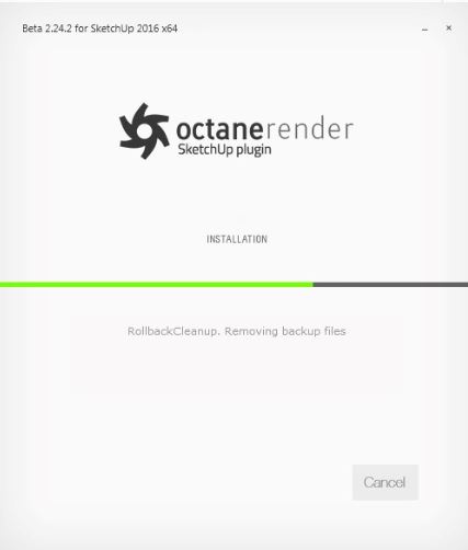

Re: OctaneRender for SketchUp 2.24.2.1 - Test Release
Postby Jorgensen » Thu Jan 07, 2016 9:07 am
Jorgensen Thu Jan 07, 2016 9:07 am
hi captian
not sure if i should create a seperate thread for this issue.....
i have uninstalled the pluging using the installer "octane_sketchup_2.24.2_2016_x64_demo.exe" and selected remove.
i then run the uninstall tool.
i checked the plugin folder, and octane has been removed.
i now install the plugin again, using octane_sketchup_2.24.2_2016_x64_demo.exe.
the installs runs, then a second window pops up in the background, that says "setup blocked...."
i have added some screens.
jorgensen
