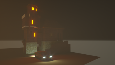

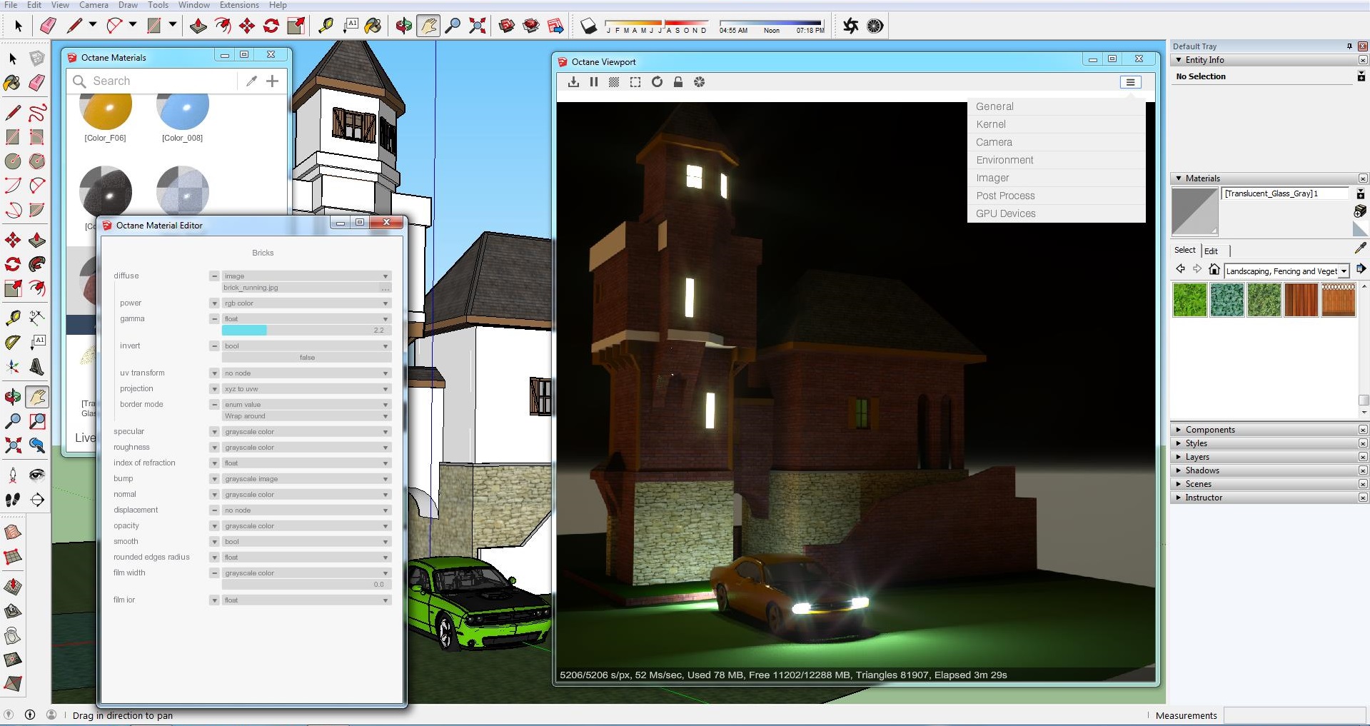

This was just a scene with other creator's 3DWarehouse components while I messed with the plugin.
And here is the Haunted 'V3 Medium Scattering' version with the standalone :twisted:

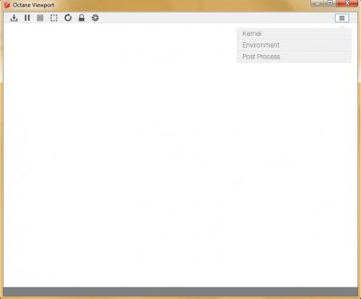

blank octane viewport.
the first time i open the octane viewport it works just fine, when i open again the viewport stays blank :-(

Postby Jorgensen » Mon Jan 04, 2016 1:44 pm
Jorgensen Mon Jan 04, 2016 1:44 pm
well it seems that the material editor is doing something, but the editor is also stays blank.
but now i can open the render view, but i need to open an close the editor every time.
i might need to update screen drivers, but there is no contact to nvidia right now.
sometimes the view looks like the attached screenshot.
as the skatter plugin did not work, i had to update internet explorer.
could that be the problem?
