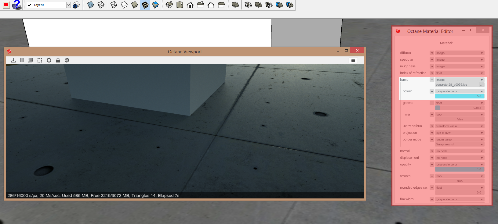

Hello all , bump does not work in this version , this is really a big thing , i wonder if any of you had problems with bump maps.
In my case , octane does not render any visible bump , no matter how i twek the values. in version 2.06 i had no problems with the bump chanel.

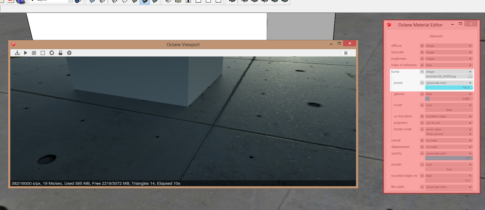

hello again , i found the problem related to my preavious post , it is not so much of an octane problem but is still a little confusing.
in the material window you have the slider for the power option on the bump chanel , when you move the slider to the absolute edge it gets to a power of 5 and it gets blue , and normaly i tought that this is the maxumum amount , until i just typed in 100 and it worked. i will atached some pictures for you to ghet what i am tryng to say
