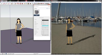

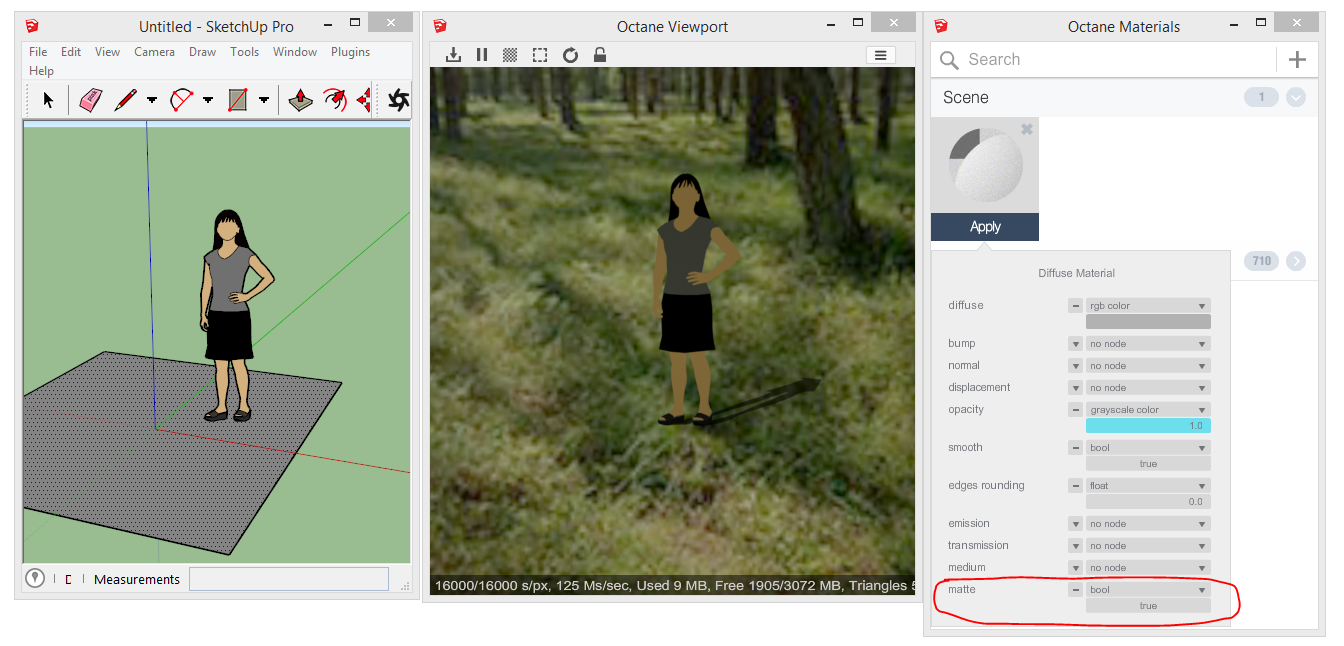

Seekerfinder wrote:FEATURE REQUEST: Would it be possible to have a function where we hide geometry that catches a shadow while retaining the shadow? Effective a shadow catcher in the plugin. I see we don't have the MATTE setting in the diffuse material node in the plugin. But having an approximation of shadows in SU without going to a 3rd party composting app would be the preferred workflow for me anyways. This would be great if possible!
Hi Seeker!
Matte should be there (check attachment). Just make sure that geometry is facing the right side. When you create a plane in SU it is facing the wrong direction (bottom), so I had to reverse the face and apply matte material to get this picture.

About matte option it works here. Normals must be correctly faced.

fuzzybro wrote:Matte should be there (check attachment). Just make sure that geometry is facing the right side. When you create a plane in SU it is facing the wrong direction (bottom), so I had to reverse the face and apply matte material to get this picture.
Oi. How did I miss that. Thanks Fuzzy.

resmas wrote:About matte option it works here. Normals must be correctly faced.
Wow. Just discovering this feature... I am so enjoying this plugin!

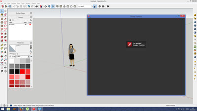

Hi... Octane Renders Team..
I have Problems with adobe flash player in Windows 8.1 (IE11 64 bit)
It does not work . i can't use the plugin
i try to fix this Problems with Adobe Troubleshooting , turn off Active x and check At-on shockwave it enable... update windows..
but flash player is not working
What should I do?
Thanks.

Bagginsnuke wrote:Hi... Octane Renders Team..
What should I do?
Thanks.
Hi mate,
It seems like you have got Flash Player 11 or 10. Please update it by downloading latest Flash Player for Windows 8.1 x64 here: http://go.microsoft.com/fwlink/?LinkId= ... lcid=0x409
Hope that helps.
Please report on your progress.

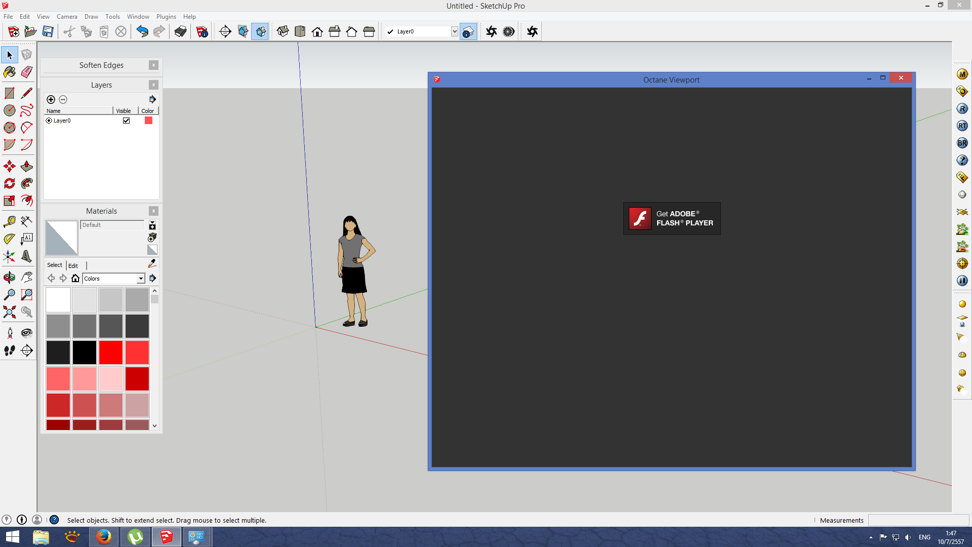

Hi Fuzzybro,
I seem to have the problem with Flash Player ( Ver. 14.0.0.145 -latest ver.) on Windows 8.1 x64.
It is happening in the license, viewpoint and materials windows.
renderlight
Posts: 30
Joined: Fri Dec 23, 2011 4:19 am
Re: OctaneRender for SketchUp 0.10.621
Postby fuzzybro » Thu Jul 10, 2014 2:01 am
fuzzybro Thu Jul 10, 2014 2:01 am
renderlight wrote:Hi Fuzzybro,
Hi renderlight,
what kind of problem?

The problem is that I can't get into windows I mention,because it comes up that I need to install
Flash Player. I have the latest Version for Windows 8.1 x64 installed.

renderlight wrote:The problem is that I can't get into windows I mention,because it comes up that I need to install
Hi renderlight,
Could ypu please post some screenshot of windows that are not working properly?
Also I would need you to open this page ( http://www.adobe.com/software/flash/about/ ) using Internet Explorer and send a screenshot.
And to be sure that everything is OK on the plugin side, could you please send me couple of recent log files located here: C:\Users\%USERNAME%\Documents\Octane\SketchUp\logs
Upd
Bagginsnuke has resolved the issue, it was an old Flash in IE.
