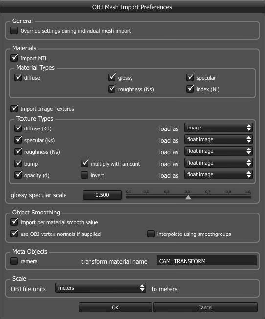

Have you changed the settings in the Octane Options at all? It should look something like this

You cannot re-export/render to the same project ocs if it's still open, so close it first.
Now re-export from SUp with a new view saved, [also with the correct parts of the dialog for camera_export ticked/filled in].
The new view that is used in the Octane render should now match the current SUp view ???
If you change the view in Octane after the export, the exported SUp view is 'lost' unless you re-run the export/render again...
If you want to export changed geometry from SUp BUT not change the view in the ocs you must 'un-tick the' camera-export parts of the dialog.

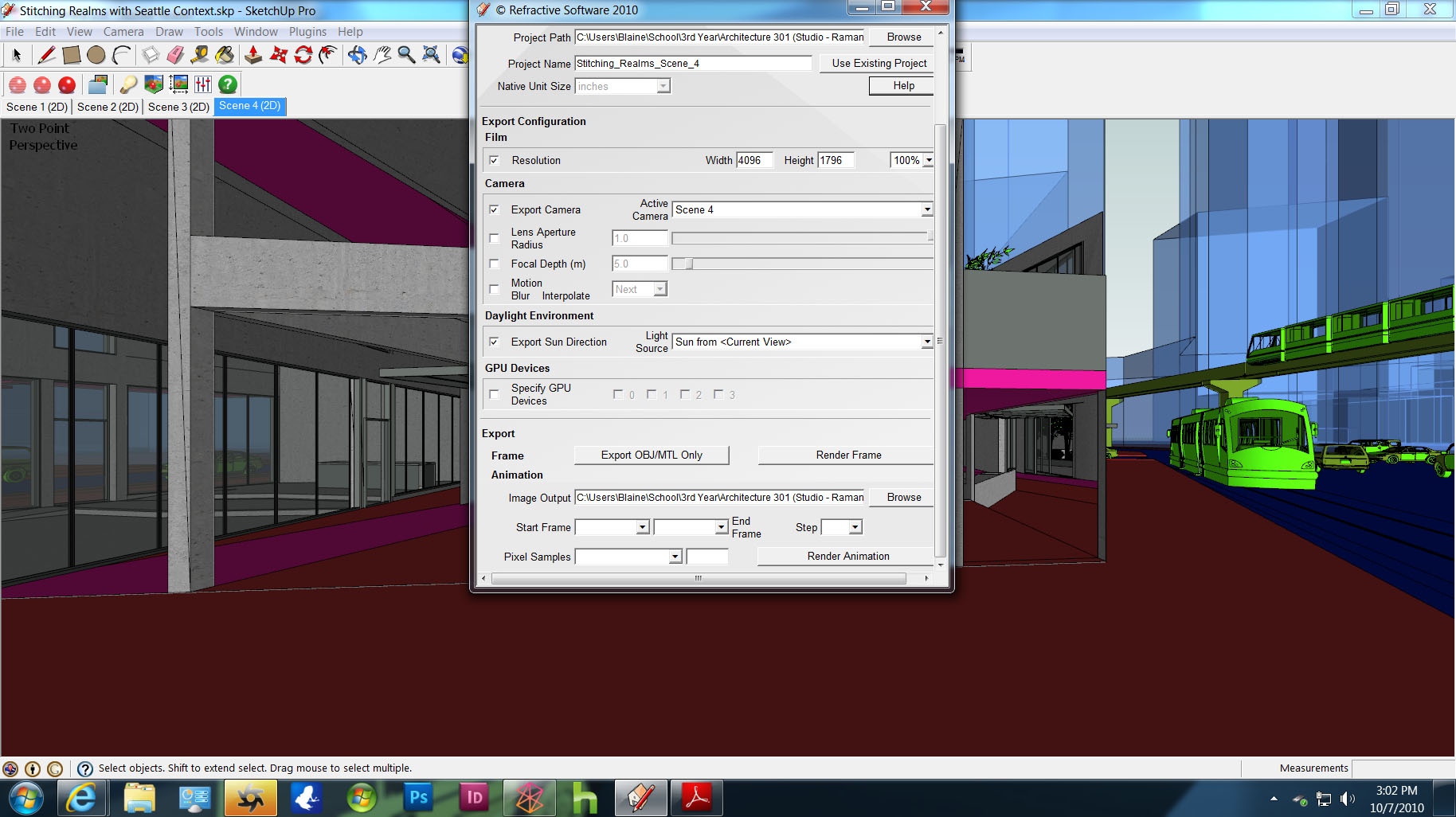

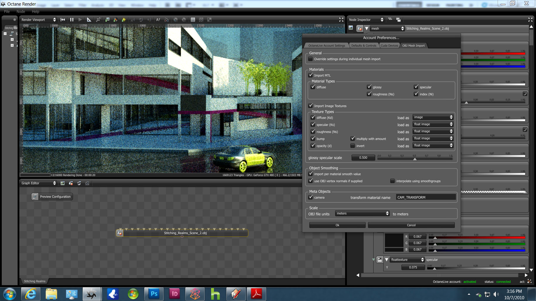

Postby bmneu » Thu Oct 07, 2010 10:21 pm
bmneu Thu Oct 07, 2010 10:21 pm
Still Issues
>>>>Sketchup>add Scene 1>add Scene 2>Save>>>>Set view to Scene 1>export to octane, *Scene 1 checked, resolution checked, default file name
>>>>Octane>adjust materials>render>save image> save .ocs>close octane (works phenominally)
>>>>Skethcup>Set view to Scene 2>export to octane, *Scene 2 checked, resolution same, default file name same
>>>>Octane>open .ocs file. Materials are kept, but view is still Scene 1 :(
I have unchecked the camera import and doesn't work either way (says its not enabled anyway). Is this the problem? Cause it's not yet enabled in octane? Or is this setting different?
I have also saved Scene 2 export to a different obj. The viewport gets represented, but the materials don't carry over when I add it as an object mesh in the ocs. Typing all the settings all over again is the next step in that case, as with any other.
The reason why I don't just move it around in octane is because I need a two-point perspective and octane doesn't have that option. I can't move it in octane without loosing that flat (sketchup calls it a 2d? perspective).....I think its a more realistic perspective. Hate the angled edges on an image if it cuts through the edge of the image constraints, for a portfolio at least.
This is the Scene I get...the before scene. Moved objects are represented in between scenes, but not the viewport.

Postby TIG » Fri Oct 08, 2010 11:38 am
TIG Fri Oct 08, 2010 11:38 am
You say you save Scene 2 to a 'different obj'.
Are you therefore changing the project_name ??
If you do this a new obj/mtl gets made BUT so does a new OCS project and that will default the materials again!!!
You have two Scenes in your SKP - 'Scene 1' and 'Scene 2'.
You export 'Scene 1' as let's say 'my_project' into a set folder - export camera and perhaps lighting settings from the SKP... it makes OBJ/MTL files ['my_project.obj' etc] and a new Octane OCS ['my_project.ocs'] as this is the first time you have run the tool, and renders it etc, you can adjust the materials etc as desired, save/close the OCS.
Make some changes to you model - e.g. move chair.
NOW in the SKP change to 'Scene 2'.
Export 'Scene 2' with the same project_name/folder... it makes new set of OBJ/MTL files ['my_project.obj' etc] - these might be the same as before, but because you might have changed geometry or materials it is always done. It will use the existing OCS 'my_project.ocs' - it imports the updated obj and mtl file... It uses the new camera - BUT uses any settings you have saved for existing materials - any newly added or renamed materials will need adjusting by you this time. Save/close the OCS.
