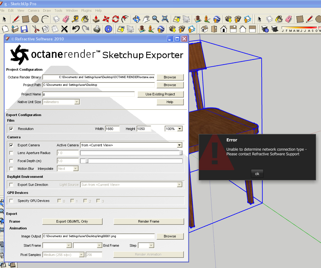

Hi, again nothing seems to work properly.I click on render frame and i get this error message that i allways get. (but when i click ok octane works fine).I still can't see my 3d model in octane though. I've exported the same scene usining the sketchup's exporter and with a little paning and rotation i can see my model just fine. Like i said before it seams like a unit problem cause im also expiriensing problems of very slow rendering times and not very good final resaults.(path traising is very very slow and i mean for a small room scene 1680x1050 at 9000 samples,it takes like 1:30h (i was using untill now the sketchup's exporter for my projects). I have only one GPU gtx 480.

manos wrote:Hi, again nothing seems to work properly.I click on render frame and i get this error message that i allways get. (but when i click ok octane works fine).I still can't see my 3d model in octane though. I've exported the same scene usining the sketchup's exporter and with a little paning and rotation i can see my model just fine. Like i said before it seams like a unit problem cause im also expiriensing problems of very slow rendering times and not very good final resaults.(path traising is very very slow and i mean for a small room scene 1680x1050 at 9000 samples,it takes like 1:30h (i was using untill now the sketchup's exporter for my projects). I have only one GPU gtx 480.
Thanks for your time.
The Octane problem needs raising with Refractive SW direct - I can't see what version you have as you have put Octane.exe in a strange path [what's up with Program Files where most things are put?]
The Exporter is written for v2.2b [and works fine with that] - I know some users with the 'unofficial version' of 2.3b have report camera export oddities...
It is NOT the SKP's units - the Exporter always uses the 'meter' as its units - Octane defaults to this [no matter what the SKP units might be!].
Have you reset Octanes units ??? This might mess with it...
The Octane units under its option/settings should always be set to 'meter'.
The render times are determined by the image size and complexity.
Try a 75% resolution - it'll render quick and you can always change it when you are happy with the materials, lighting etc...
Do not select any GPU tick-boxes - let Octane decide.
