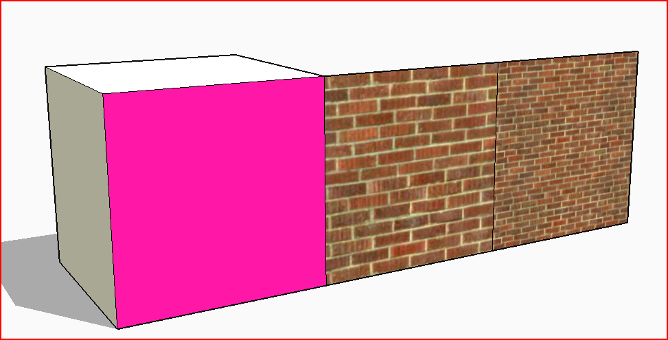

The examples below show a SKP with a plain 'pink' material and a textured brick material with two UV-mappings [the right one is 0.5 scaled] - in SKP and in OCS.

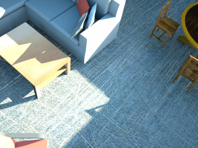

You can see that using the LiveDB>Material>Skin>Leather gives the same appearance to both swapped [relinked] materials, with both brick faces looking the same even with their different UV-mapping in the SKp and original OCS view.

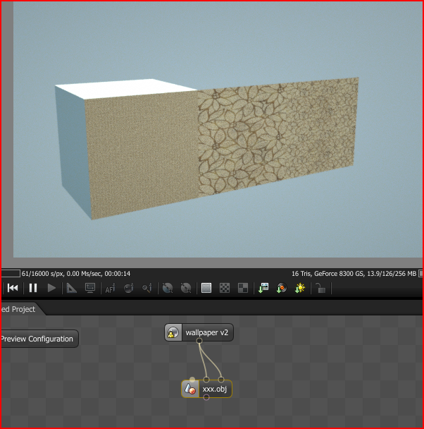

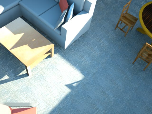

However, using the LiveDB>Material>Cloth>Wallpaper gives different appearances to ALL materials, the originally untextured 'pink' seems to loose all scaling, and the two brick textured faces now seem to respect the different UV-mapping this time - as one might expect.
