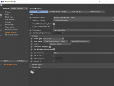

I am testing ocio with my new project.
this is my render setting(please check the attachment),and the save format is png(8 bit)
When I use the ipr to save file(save image,the same as the output setting), nothing bad happened.
But when render with the picture viewer, it crash!
driver: Studio 461.72
card: 2080s

I have just update to the newest driver.Still crashing.
I found it when setting the color space to ocio could cause this problem(the render setting of cinema4d)

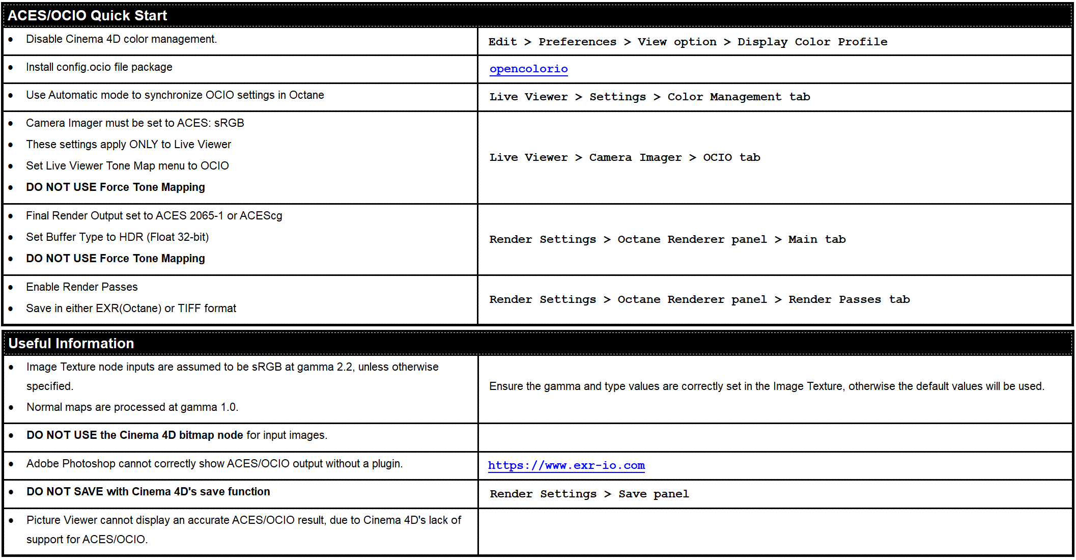

Save as HDR (Float 32-bit) not LDR. Use this chart to make sure all of your settings are correct:

If you follow the chart I posted and you have the most current version of the c4doctane plugin, it should render to LDR 8 bit without issue. DO NOT USE FORCE TONE MAPPING. You lose ALL of the benefits of ACES when you do so. Also, disable Use Denoised Beauty Pass.
