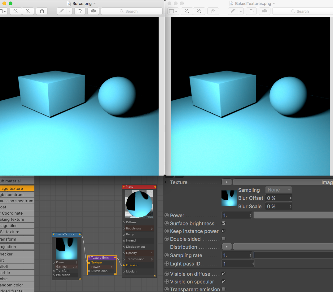

With a simple one-shot bake like you are doing, you're including illumination info into the texture, as well as the color. Try killing all your lights and piping the baked texture into a black Diffuse Material's Texture Emission slot, and bring the Emission power down to 1.
On the left is the source scene, one material, one light source. On the right is the same scene with three materials, each flat black with the baked textures driving surface emission, and no other light sources.
Simple Baked Scene
Simple Baked Scene
You can do multi-pass baking to break out the illumination, diffuse, etc into separate layers, but that's a bit more involved.
