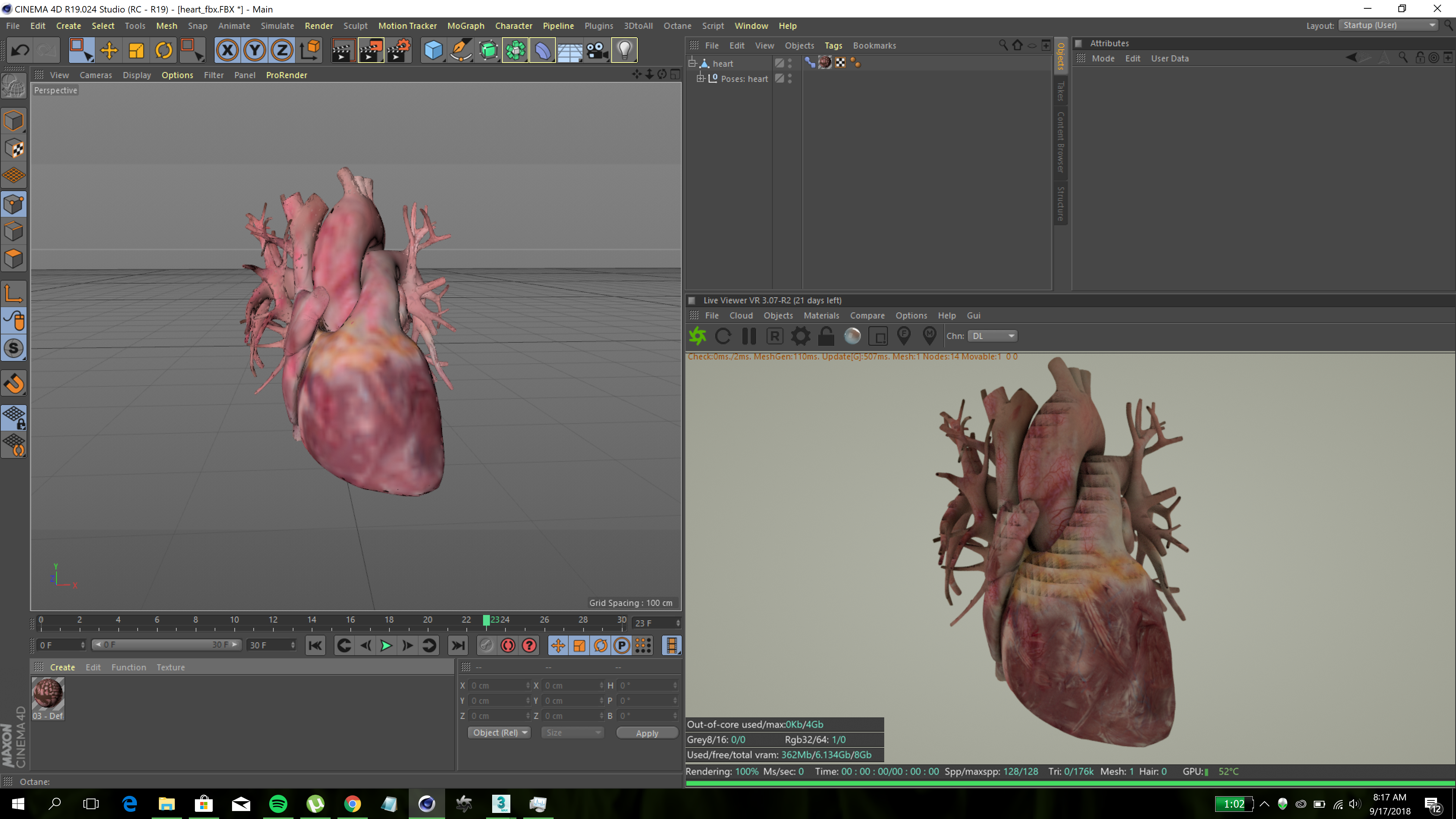

Can anyone help me with this? This is an fbx export from 3ds max and it looks like this (see attachment) in my octane live viewer, looks normal when I render with the default renderer in c4d.

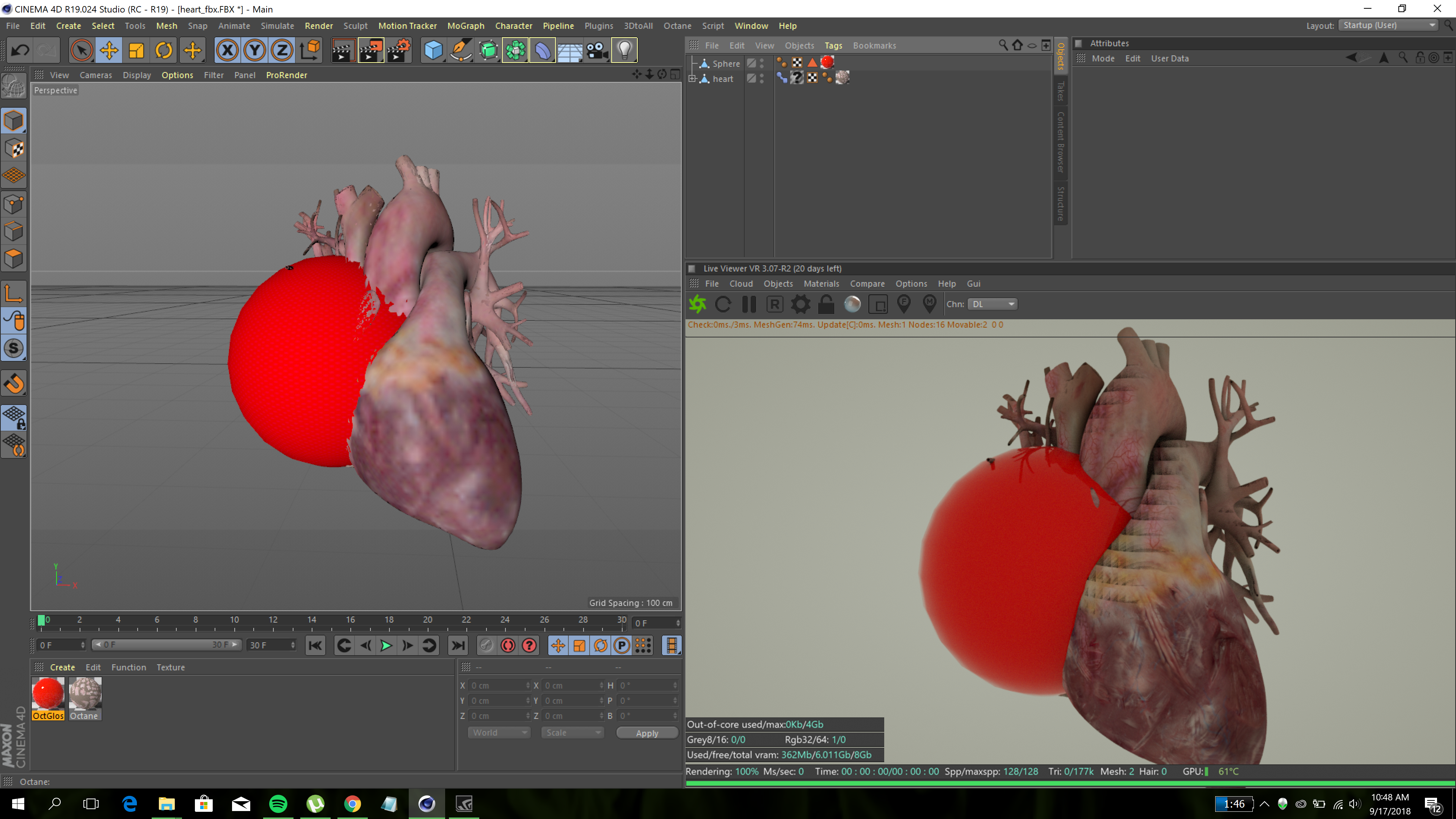

Put a sphere in this scene with some material and check how it's looking.

aoktar wrote:Put a sphere in this scene with some material and check how it's looking.
sphere looks fine

Your mesh looks like very big on dimensions. Read ray_epsilon from manual what's that and play with that!

aoktar wrote:Your mesh looks like very big on dimensions. Read ray_epsilon from manual what's that and play with that!
worked thanks!
