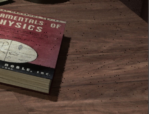

On some scene with several lights, I have black dots remaining on the image
even with 36000 samples
the higher I go the less noise I have but still getting those black dots at 36000 samples, really !
Here is what I mean ....

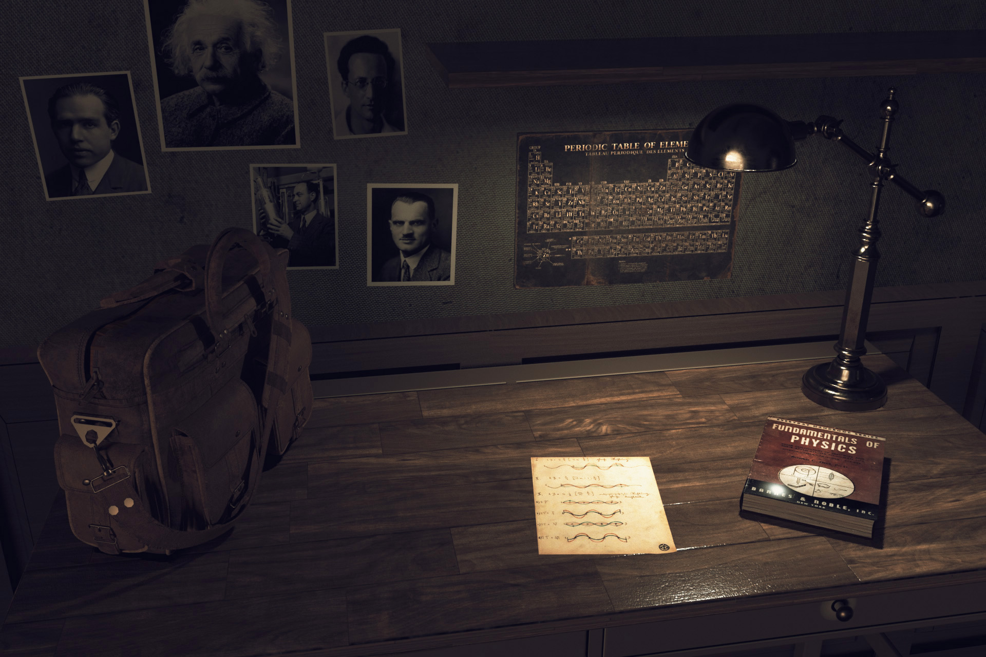

The s scene here rendered at 2000 with only one light and one hdri
and without the "Tesla" item, the new octane 4 denoiser just works fine and give me a great sharp image even at 500 samples

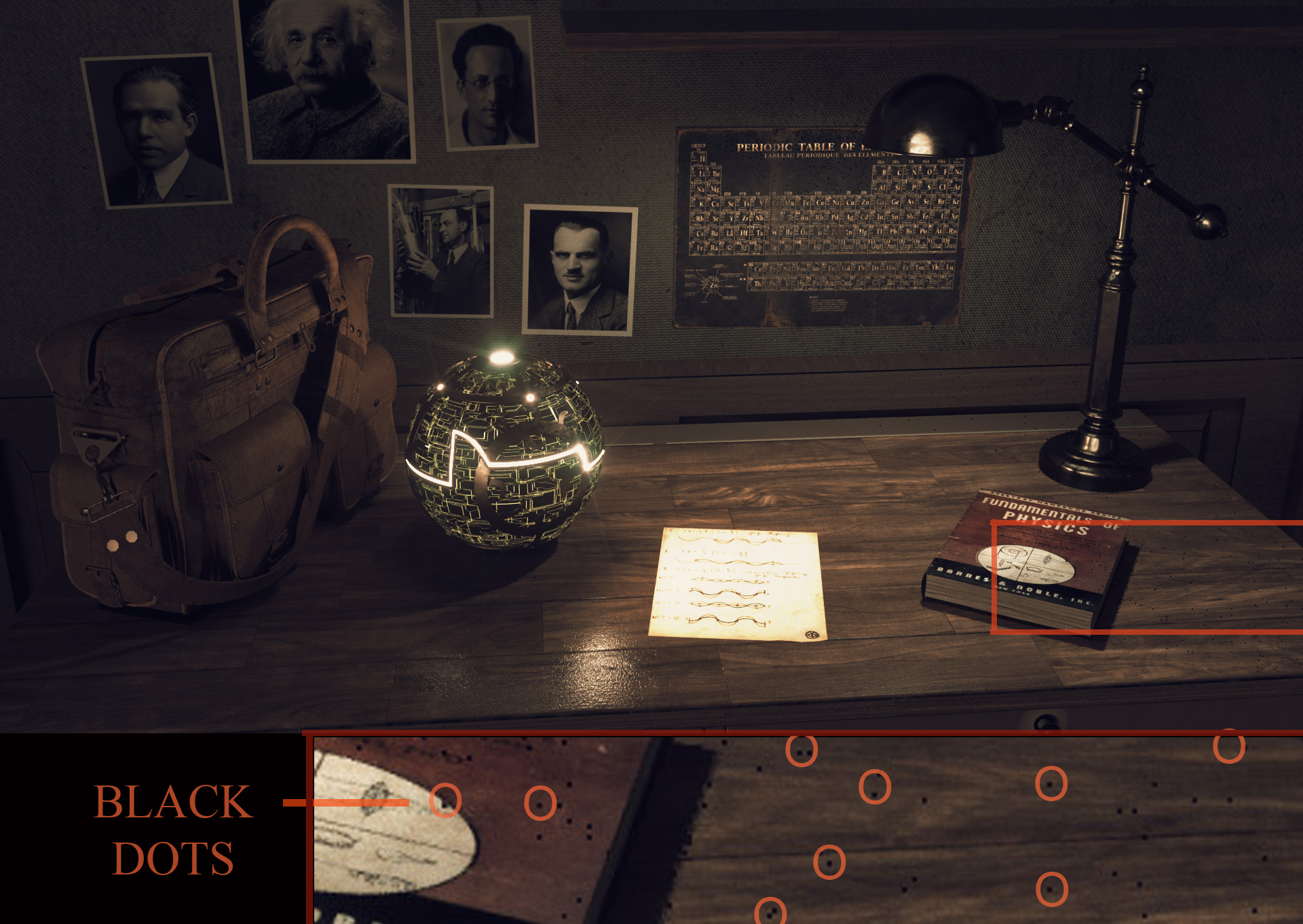

And the same scene with the "tesla"item which as some geometry on which an emission material is set...
at 36000 samples
You can see the difference ...

Anyone has suggestions on how to remove those black pixels or dots ?
