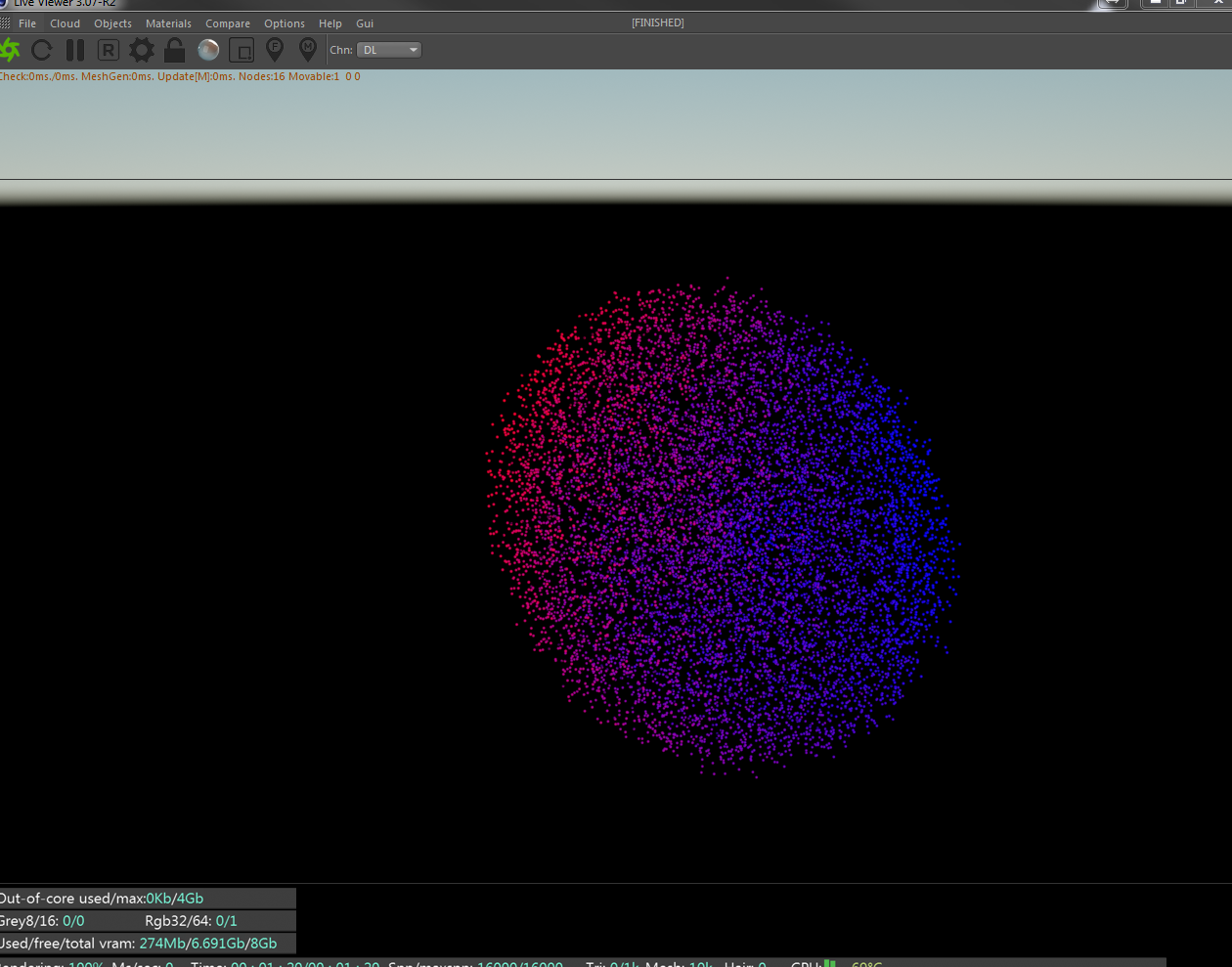

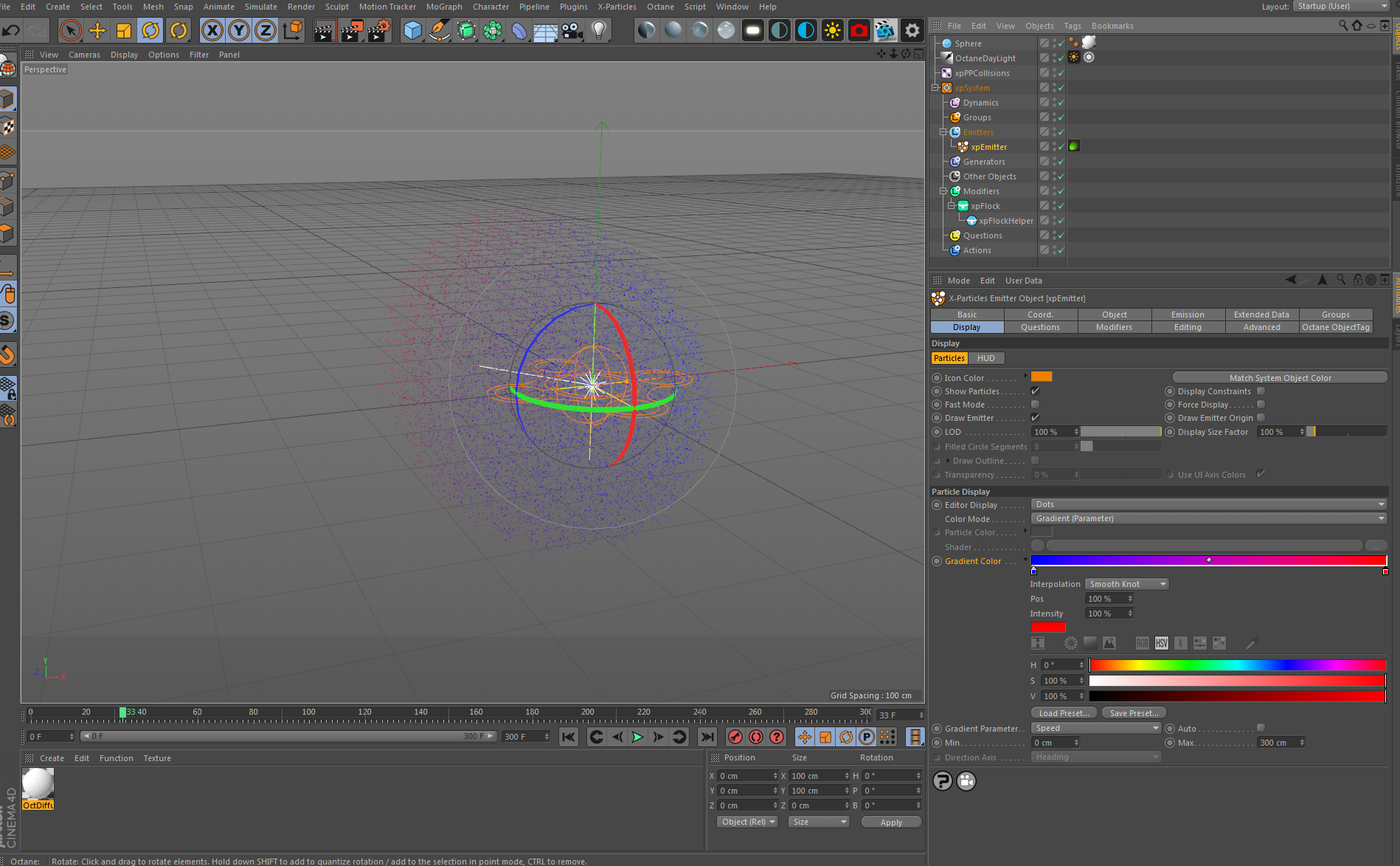

I am not sure if you found a solution to this yet seeing as the post is almost a year old. But I was able to achieve what you are asking, I think. I set the particle color under the emitter (set to gradient and speed). I then created an octane shader and put an instance color node on its and used particle as the source and the emitter as the Color Source. So now the color changes with the speed and it is represented accurately in Octane.

Worked for me! Thanks bluerockrendering ! :D
