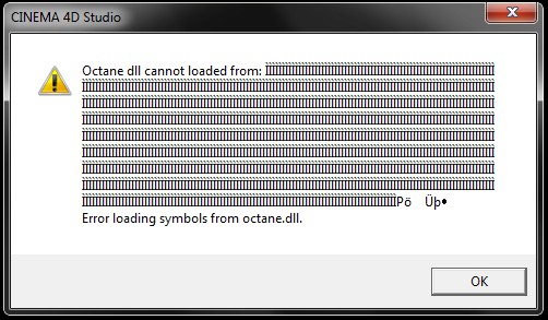

Octane is running again. I reinstalled the NVIDIA Driver, did a full reinstall, and switched to 320.18.
No error screen on start up anymore and all GPUs are there.
But after 3 Minutes of rendering I got a bluescreen again... and 2 GPUs are off.
