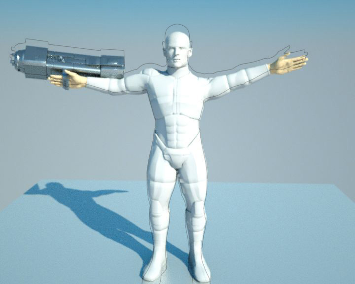

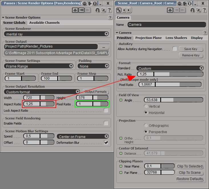

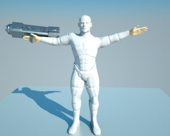

In Octane, a pixel is a square, so that a pixel ratio of 0.9 doesn´t work correct.
Use a pixel ratio of 1 in the render options and copy the aspect ratio from the render options to the camera picture ratio.
A other thing is, that the result not 100% match between Octane and Softimage/Maya/Max, maybe 99%...
