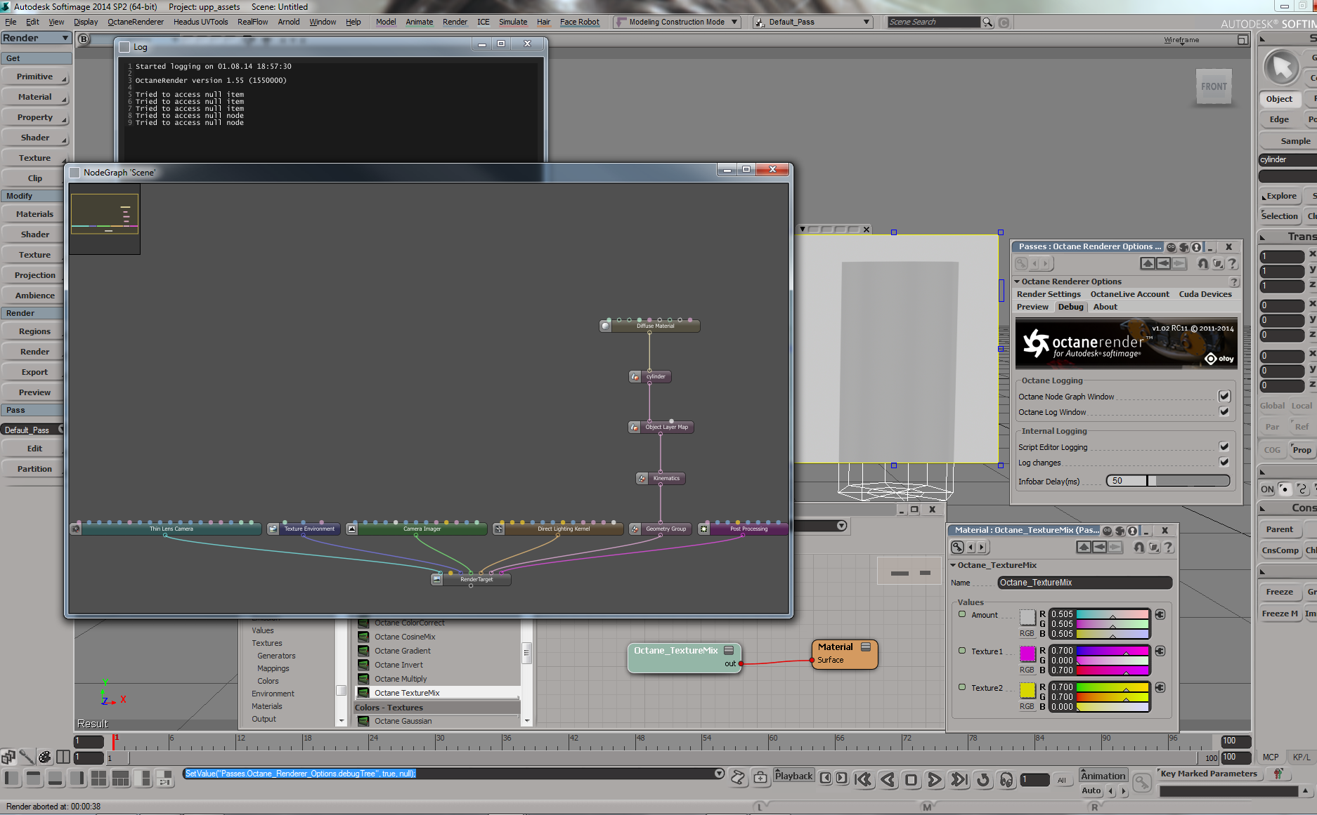

ivom wrote:Something is wrong with Texture_Mix node. Whenever I'm using it, material behaves like standard diffuse. When I debugging scene graph it doesnt translate texture_mix node at all. See attached picture.
You have a texture_mix and a material_mix. The first is only for textures, the other onyl for materials.
This is bad to handle in Softimage because they used the some output pins.
