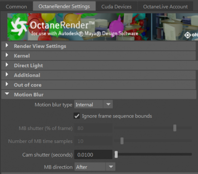

1) How to show Motion blur?
There is a Motion Blur Type under the render settings, which is set to 'None' by default, but I tried both 'Subframe' and 'Internal', and messing around with the parameters doesn't seem to do anything.

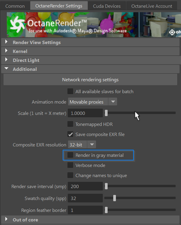

4) Where is Clay Mode?
I use it quite often in the Standalone, but I cannot find it in the plugin.

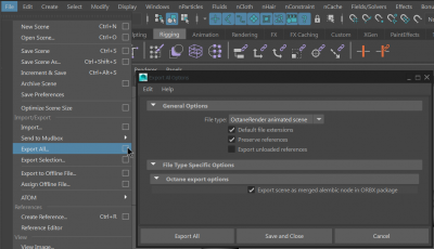

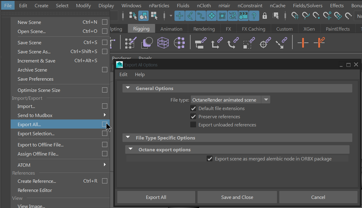

5) How to import/export .orbx files?
This is an essential feature, I cannot find it anywhere.
