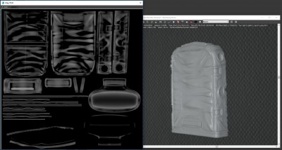

you can obtaine a correct texture into Octane but at the end you have to use a baking node so to speed up the process would be converting to grayscale in photoshop.
something as in this case:
viewtopic.php?f=30&t=56508&p=289968&hil ... an#p289968
