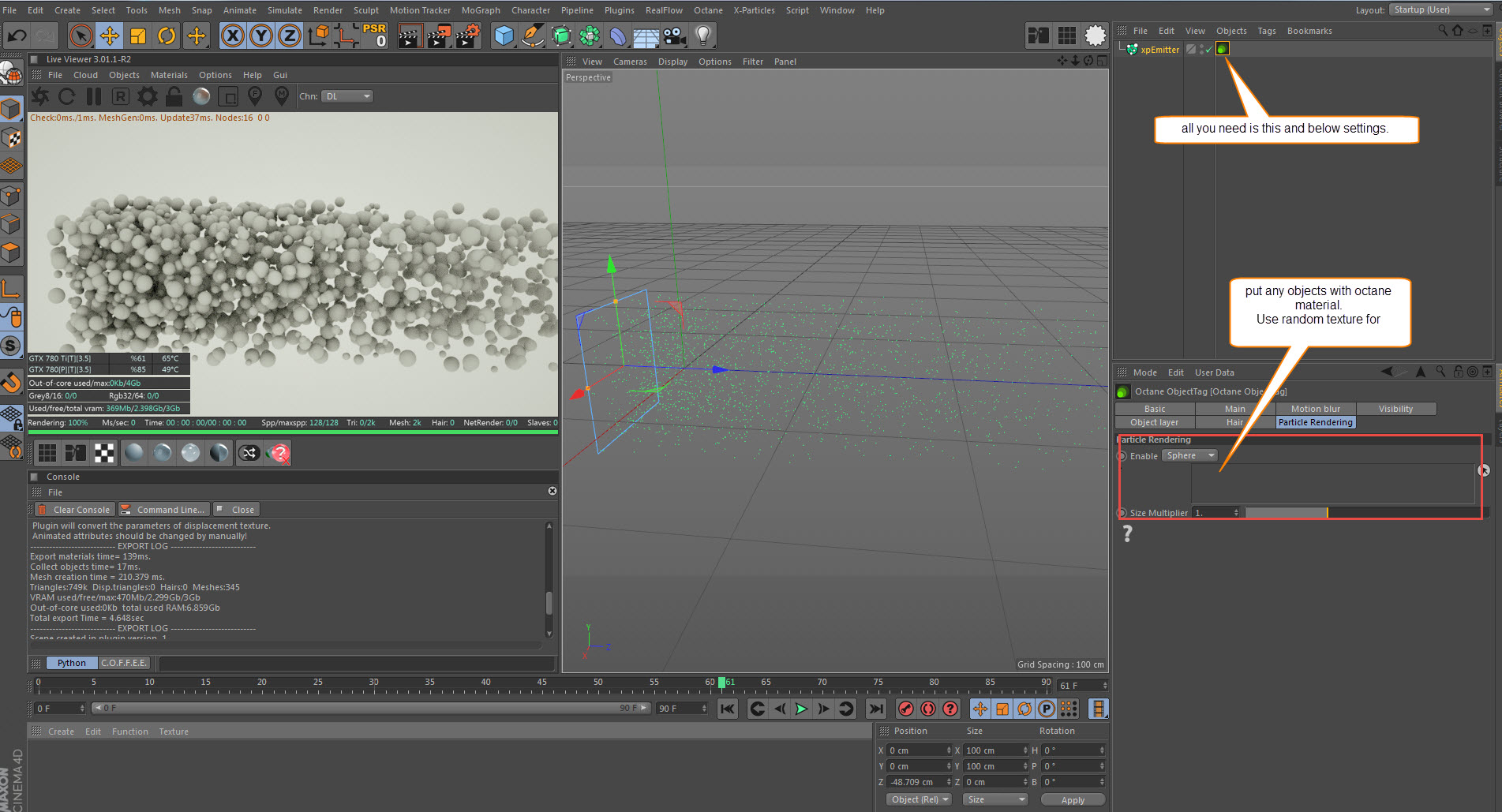

by aoktar » Thu Jun 16, 2016 12:05 am
See image. It's very simple as you can see. Doesn't work with demo x-particles or lower than 2.5 as i know.
