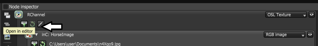

Steps:
- Create a new OSL Texture node
- Select it and press the Edit Code button
- A code window will now pop up. Place the following code in it and press the play button.
Code: Select all
shader RChannelAsGrayscale(
    color inColor = 0,
    output color c = 0)
    c = color(inColor[0]); //return the R component as a grayscale color
- The OSL Texture should now have a new input pin that takes a texture. And it will output the R channel of that pin as a grayscale texture
