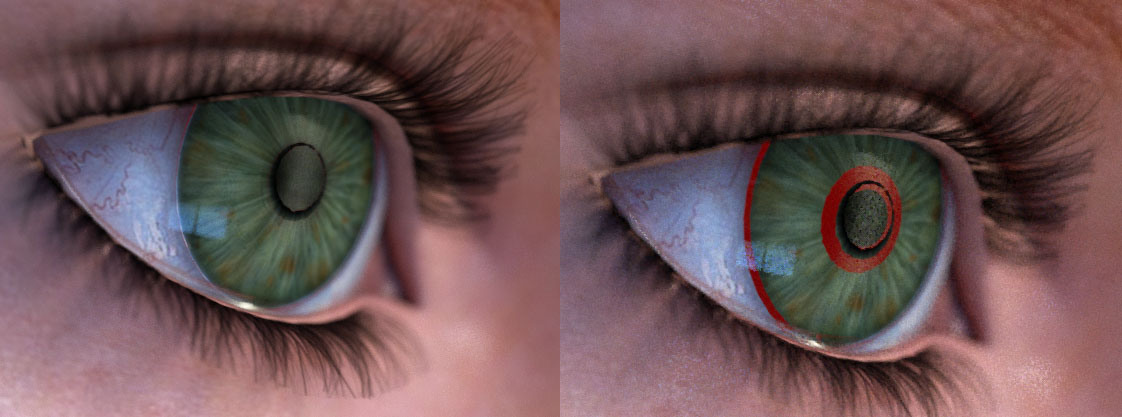

Okay, this is an interesting one. A new Weight Mapped version of Victoria 4. She's free to download, but there's a weird issue. Here's the link to grab it if you want to take a look: http://www.sharecg.com/v/88918/gallery/ ... -for-POSER

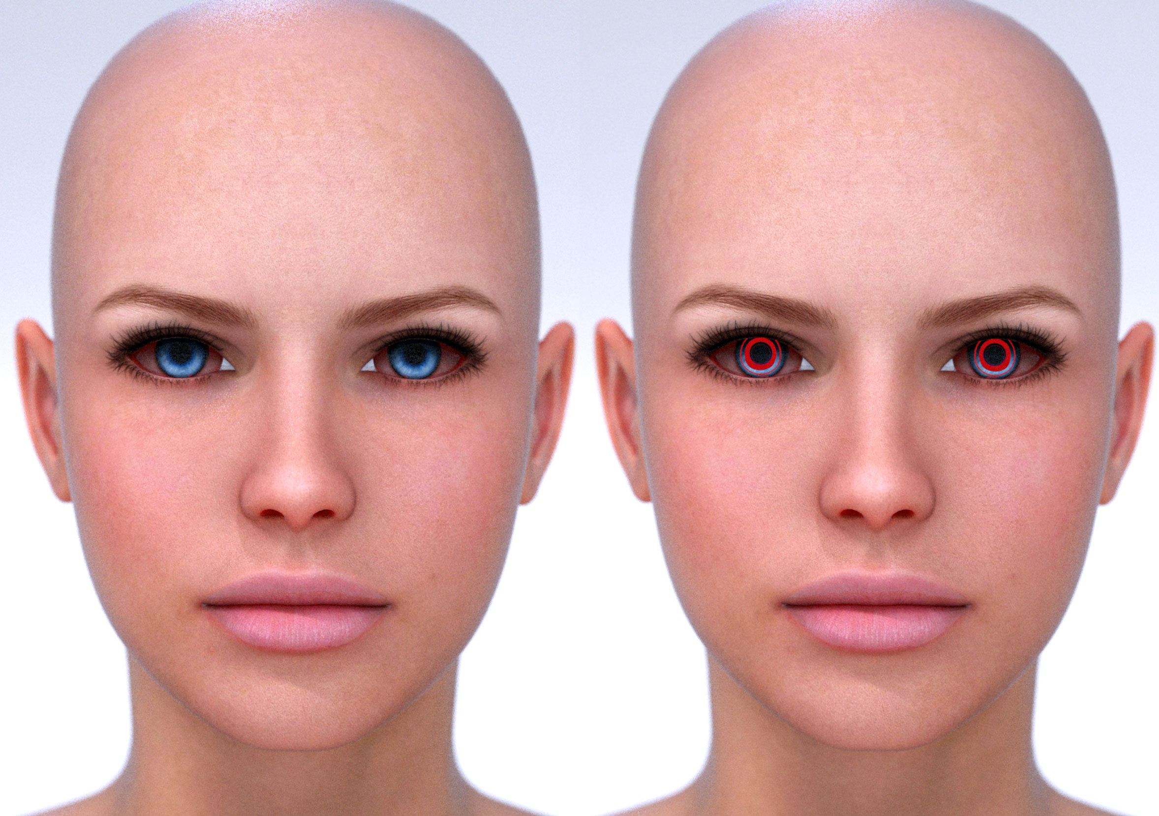

There's two issues, one is easy to fix. That one is that 4 props are created which just need to be made invisible. But there is another more serious one. Here's a quick render of a character in V4 (left) and SASHA-16 (right). Both are the exact same texture. I have seen other issues as well, like where the eye just ends up a black void. Any help you can give to try and fix this issue, would love it.

A quick is to change Octane Settings / Kernel / Ray Epsilon / settings to ZERO if it doesn't interfere with other parts of your image render.
There is something about the SASHA EyeIrisConvexity setting that changes it..
This is the same settings change to fix the 'tears' abnormality in some model renders..
(thanks for showing the SASHA16 model, quite busy but something new to try out..)

That's odd. Is there that much change in SASHA-16's eye over V4's? And wow, you are right, that fixes the tears too, very nice!

Glad that helped, not sure if it's "THE" fix to the problem but even when you change the skin (from someone else's model, that red circle problem persists..) The eye has a lot more morphs to it than the standard V4 eye.. don't know if you need THAT much detail but meh..

Well, this is cool! Karina figured out what caused it and made a fix for it! It's on the Sasha-16 forums (in the documentation) but I have a feeling there will be a fix eventually implemented.
