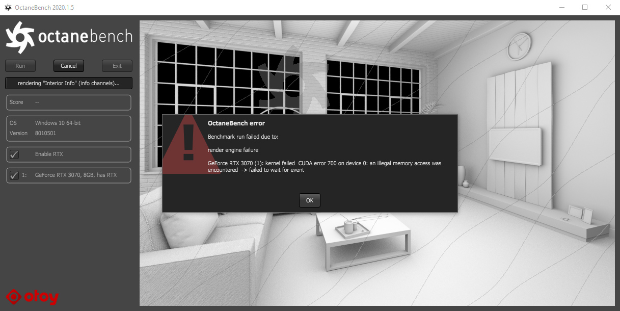

Just replaced my GTX960 with a RTX3070. Updated to the latest versions of Blender Octane and Octane Server - Blender_Octane_Edition_2020.1.5_22.0_xb and OctaneServer_Prime_2020.1.5_22.0_xb.
If I turn on 'Use RTX acceleration' in device preferences the render quits very quickly after around 60 or so samples and I get "CUDA error 700 on device 0: an illegal memory access was encountered" in the Octane Log.
With RTX acceleration turned off it renders fine.
I created a reg entry for TdrLevel 3 and TdrDelay 60s. Didn't help.
I used DDU and made a clean install of latest drivers. Still stops rendering.
I tried earlier drivers but 457.30 are the only ones compatible with RTX3070.
I'm on Windows 10 v1909 with 32GB system ram.
Is this a known bug? Or should I be able to use RTX?
(Also the Denoiser isn't working).
