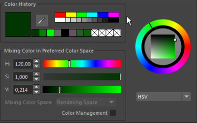

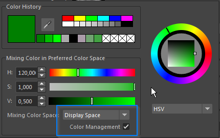

calus wrote:QuinceHungaryKft wrote:The values for material setup are colour managed making it difficult to fine tune properties. For legacy compatibility I propose to implement a checkbox for disabling colour management on a value.
Not sure what you mean here,
as far as I know, values itself in Octane Material are not color managed, only the color swatch display is color managed by Maya,
in the color picker you can set color as you like, using display space or rendering space or without color management.
What am I missing ?
